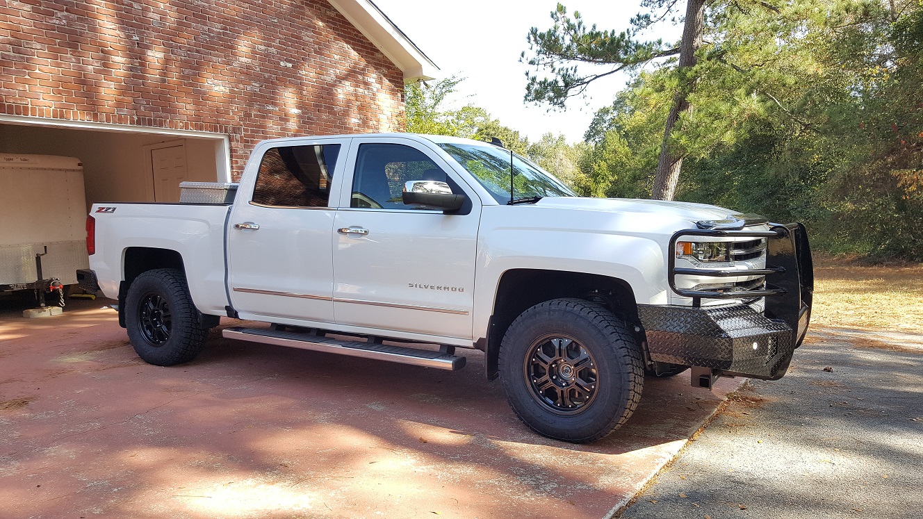

My 2016 Silverado with 1.5" Rough Country leveling kit and new tire setup. 17" rims with 285/70/17 Nitto Terras. Pretty sure I could've fit 33". These are 32.75".

2.5" RC Full Level
20x10 -24 Fuel Nutz
33x12.50R20 Atturo MT's
Only a very, and I mean very slight rub at full right lock in reverse. It's so minor, I'm not even going to bother with it.

Looks good! Any rubbing???
Only VERY slight rubbing of the fender liner at full lock in reverse. Not even enough to warrant ziptying the liner back until the next time I am under the truck.
