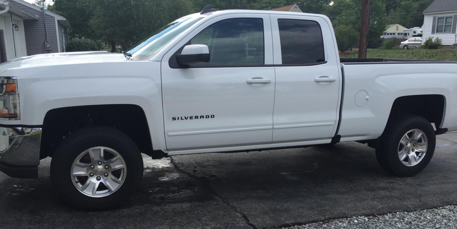

That's great, do you happen to have pics of how it looks with the 3 inch blocks?
This is mine with 3 inches all around

All around? That looks level, where is the rake? Did you do 3 front and a 3 inch block in back? That would be essentially a 1.75 rear lift.

Correct as far as I remember the stock block is 1.25 so the rear got lifted 1.75 inches. The front a full 3. With the original level it was a 3 in front and a 2 inch block in the back. With that it looked like a slight slight squat in the rear. Adding the 3 inch rear block gives almost no rake. On flat ground you have to stare at it to see the ever so slight rake.
