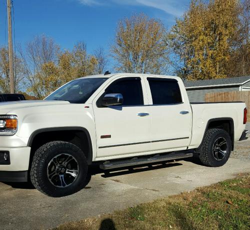

Heres my 2014 GMC All Terrain
2" level kit
285x65x18 Toyo Open Country AT
18x9 XD Cranks 0 offset
I planned to install a 3.5 lift but since I have zero rubbing issues Ill leave the hight as is for the nice ride.
Its also the "lowest" 4wd Ive ever owned.post-165476-0-20598500-1479691489_thumb.jpg

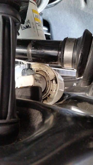

Installed RC 2" level last weekend (2016 Silverado with stamped steel arms). Instructions state to install on top of shock mount pointing down. Due to the CV shaft being in the way, this isn't possible for one of the bolts. When installing that particular bolt pointing up (as instructed in many of the online videos) it makes contact with the CV shaft. It seemed very slight and only when the arms were fully dropped. I thought the vehicle would have to leave the ground for the bolt to contact the shaft. A two mile test drive proved otherwise. I had to cut 1/4" off the interfering bolt and now it's fine. Has anyone else seen this?
Yes very commonly talked about here. You must install them bolt going down for this reason. You must remove the upper ball joint and tie rod end entirely from the knuckle so you can move the hub out of the way to install the bolt going down.
Yep, removed tie rod, upper ball joint and sway bar connector. This allows hub to move, but doesn't change position of CV shaft, other than up and down. Not nearly enough allowance for the bolt . Maybe I'm missing something?
I just cut the bolt last time I put one in.
Worked great.

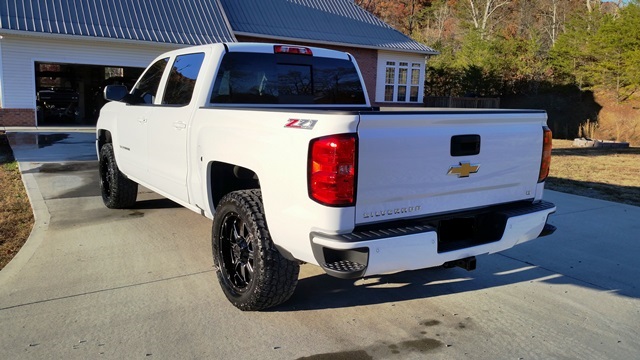

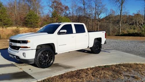

Just got the 2" motofab front leveling kit. Pictures are with the 295/65:18. No rubbing. This kit lifts the front 2inches but it is now not level in the back.
Edited by COchevy
Glad to hear the tires aren't rubbing....they fill up the wheelwell nicely.
Your cap is probably weighing down the back a little. I personally don't like the look of a level without the rear 2" block. Even with a 2" block in the rear, I run rear air bags to keep the back from sagging when loaded or when towing.

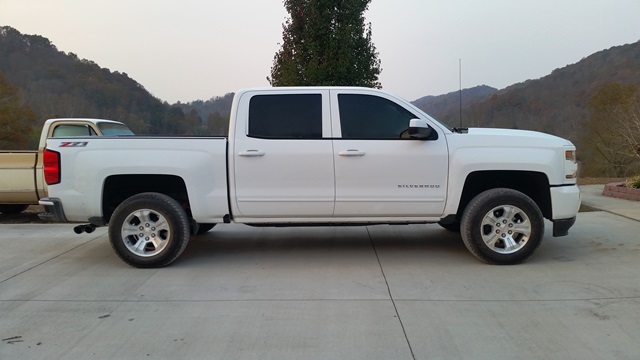

Read through almost the entire thread. Until i decided on motofab 2" front leveling under strut spacer. Will be doing the installation myself and posting the results. Received the kit already and just need to gather the tools necessary. Hoping for a 3/4" rake.
Current stock height front 36.75" and rear 39.5" Truck is a 2017 ltz z71 4x4 for reference. Spacer measures 1.25" which If iam correct a 1:2 ratio would produce 2.5" lift but we shall see.6cc8efd1e6909f45f21f4a2225a4d8a7.jpg
