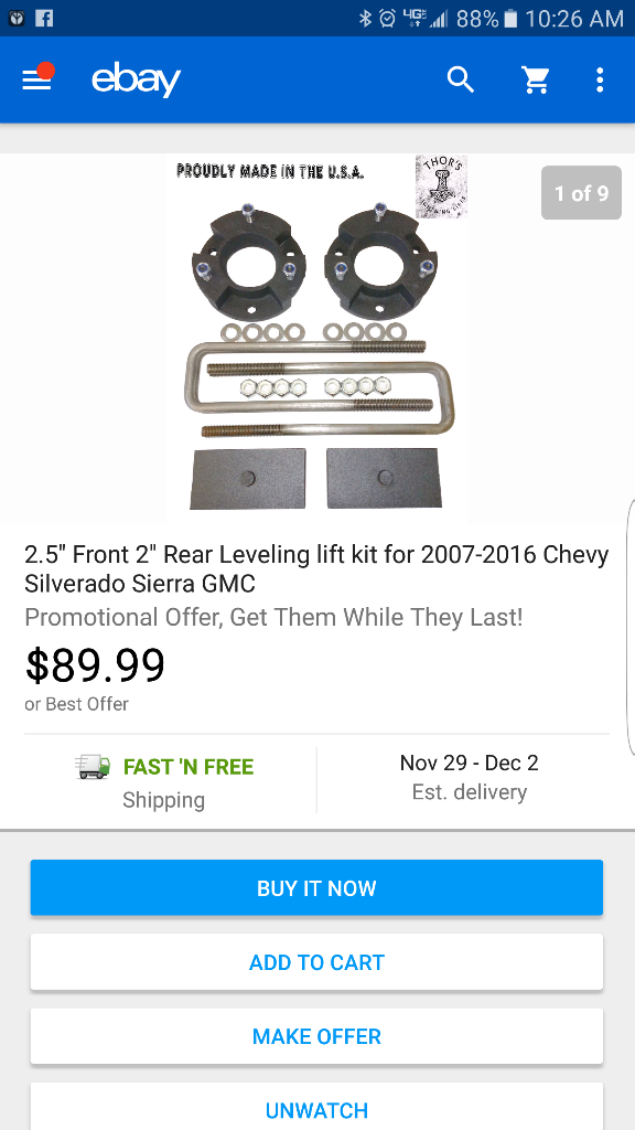

Is it worth saving the $35 on a knockoff kit or just buy the Motofab? They are surprisingly cheaper on ebay and I'm about to pull the trigger. I see they sell a lot of 3" kits on ebay as well. I'd love a 3" but have read about all the negatives to it.
After weeks of researching this I went with the motofab.
