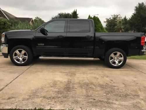

Tires: 285/65r18 Nitto Exo Grapplers
Front: Fox 2.5" Non-Resi Coilovers & Cognito UCAs
Rear: Fox 2.0" Non-Resi Shocks
Front Ground-Fender: 40"
Rear Ground-Fender: 39.5" (Plan to replace stock block with Zone add-a-leaf)
Stock:
IMG 0991

Nice set up! Any rubbing with the Cognitos?
No rubbing on the control arms. The coilovers did give me a little more lift causing a little rubbing on my sway bar at full lock though.

How is the ride w/this setup compared to stock?
I was thinking of running a similar setup as I'm not too happy with the stock ride. I think there's only a handful of guys on here that are running the same thing, so any feedback you can give would be helpful. Thanks!

Would a skinnier tire clear the sway bar then? Like a 275 ILO 285? Planning on a 275/70/18.
Also what did you set your coilovers on? Max/2.5" lift? 2" lift?
Curious if this is because of the UCAs or the coilover/tire combo.

I am very pleased with the ride. It's definitely more firm than stock, but that's also what I was looking for. Much less body roll around curves and a lot less rebound bounce from the suspension over uneven asphalt.

A skinnier tire should clear no problem. My rub is extremely minimal with the 285/65R18 - like barely scuffing the sway bar enough to notice.
As for the lift, I'm not 100% sure how much I ended up with because I had a Rough Country leveling spacer on before installing these coilovers and don't remember my stock measurements. With the Rough Country spacer I was sitting about 39" from ground to fender in the front and out of the box my Fox coilovers had it sitting at about 40.5". I'm in the process of playing with the preload to find a height I want to stick with, but I'll more than likely end up around 39.5" to 40" in the front once I'm done.
Right now I'm actually sitting a little nose high with my front measurement being 40" and my rear at 39-39.5", but I do also plan on going with an add-a-leaf in the rear to help with sag and keep things level when hauling a load.
