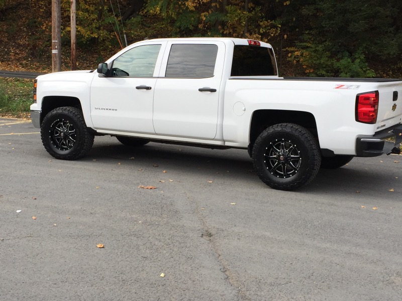

I went from stock rims to a -12 offset little rub full lock. 305-65-18
From +24 stockers to -12 is a big jump especially with a 2" level.
You're one of the few running 305/65r18, so any info on the stockers before you got new rims would help a lot of us. Any reason you went away from them?

Just for looks pretty much. No issues with stock ones at all. No rubbing or anything. Ya the -12 was a big jump almost to much cause now I have rubbing on the little black plastic peice on rear of wheel well in the front. Maybe a 2 1/2" level will give me enough room to clear. It's only pulling into parking spots or backing out.

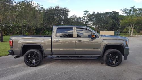

2" Suspension Max Level kit on my 2017 6.2 Denali attachicon.gif2017 Denali 5.jpg
This is a sick color combo. Very unique!
