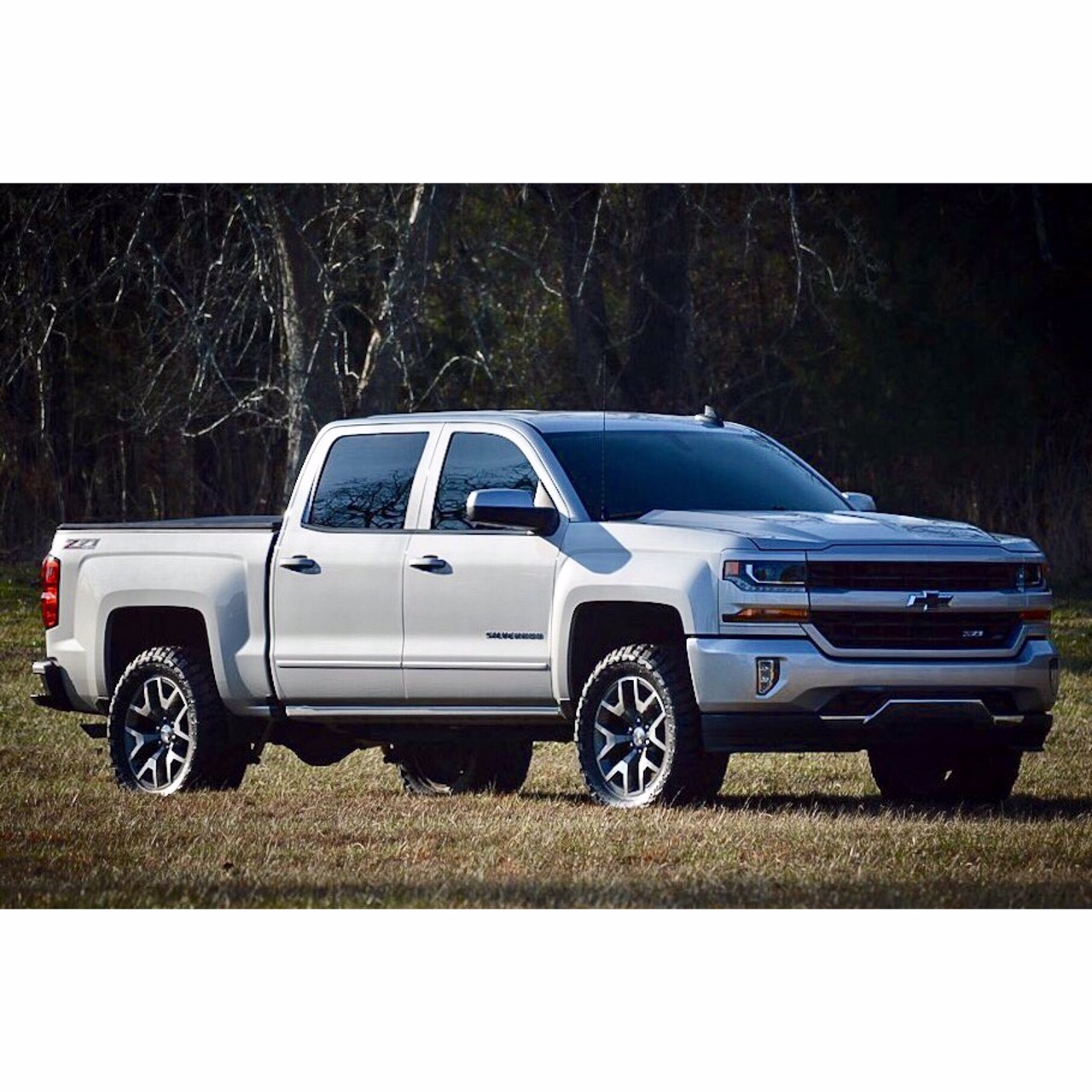

Good evening Gentleman. Long time lurker, first time poster. I bought my 2016 LT CC in June of 2016. I'm currently stuck between a 2.25" procomp leveling kit or the 4" procomp lift. I'm looking at running at 20x10 -24 offset wheel on 33s. Not sure of a tire yet. Does anyone know if this will rub? I'm okay with trimming the front valance some but really not comfortable with the idea of metal trimming. If I need to go down to a 20x9 0 offset without having too many issues so be it. I'm willing to compromise...to an extent lol. Thanks ahead of time!
go with a -12 offset and it will rub very little no trim will be needed
SuperAllTerrain
Yeah true. Not a fan of all that either. I've decided on the motofab 2.5" front kit but I'm going back and forth between the 1" and 2" blocks to go in the rear. Do you have any pics of your setup?
2.5 is a great safe bet for sure, and will Look awesome. Not sure if all factory blocks are 1.25, but mine were. 2.25 left me with about 1 inch of rake.

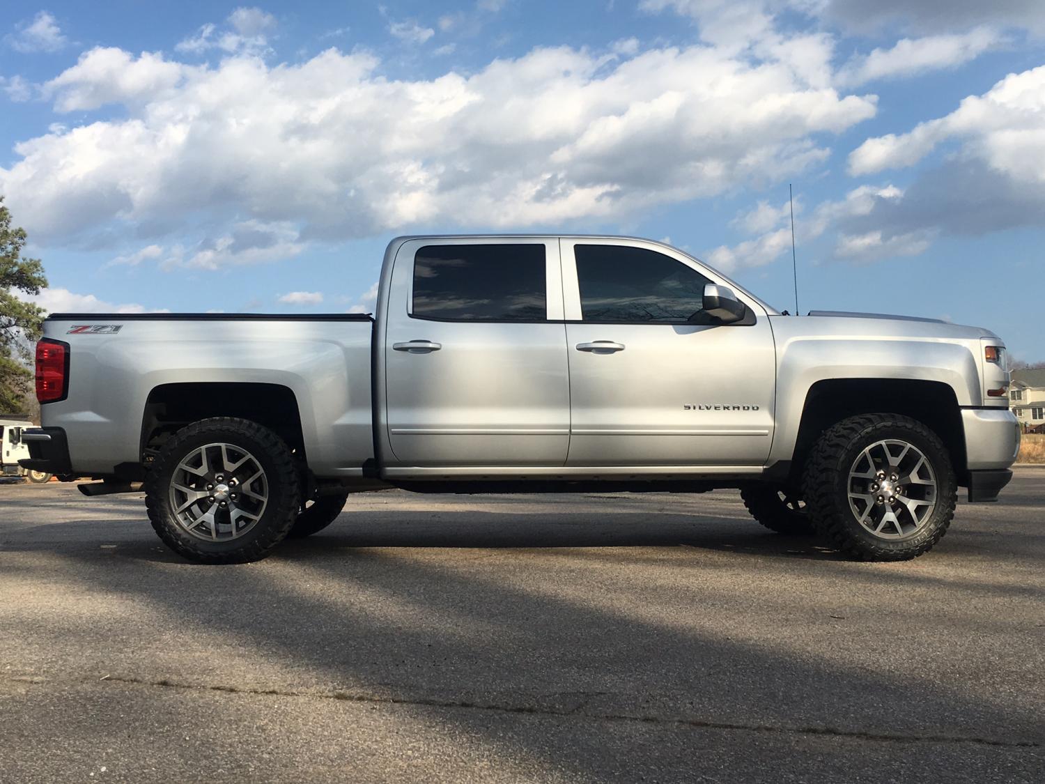

Removed the RC 2 in level and installed Bilstein 5100 all around with the front set at the highest setting.14b2b255671860c5f92c49611a4da9a3.jpg
Sent from my LG-H820 using Tapatalk
I'm...yeah. That settles it. I have an identical truck, and that's just the look I'm after. Sweet ride.
Do you know how the front to back now measures? How's the ride? I would like to go this route.
Front is at 39 and rear at 39.5. Ride is a better than the stock Rancho

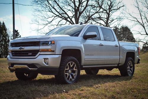

Here's another one with 2.5" front and 3" rear with 305/55R20's. I got my 3" from RC and the ubolts had to be purchased separately.
Part #'s:
9/16-inch Square U-bolts (2.5 x 10.5)
7652
$29.95
3-inch Rear Lift Blocks
6594
$33.95
IMG 0336
I have a difference of almost 1" at the rear fenders.
Driver side fenders are 37 1/4" front and 38 3/4" in the rear; 1.5" difference.
Passenger side fenders are 37 3/8" front and 37 7/8" in the rear; 0.5"
This is after I just put Bilstein 5100s at the highest setting on the front and no change to the back.
I know the rake in these trucks aren't always consistent but has anyone seen the difference of almost 1" in the rear? Do you think my rear passenger shock is shot causing the 1" sag? Seems weird to me at only 20,000 miles but they are the stock shocks on an LT.
