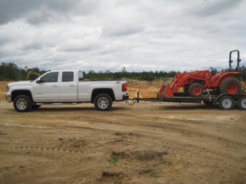

Hello all, just got my 2014 Sierra 1500 looking to do a 2" or 2.5" leveling kit and need some recommendations. I also tow a camper and was looking to putting airbags in. Has anyone done both and what brands have you used. Thanks for the help
2014 GMC Z71. 2.5 RCX with rear block. 275/65r18s Nitto G2s on stock GMC Z71 rims. Firestone Ride Rite Air bags. Trailer weights 2300#. Tractor weighs 5000#. Put 30psi in bags and it levels truck out while towing.
