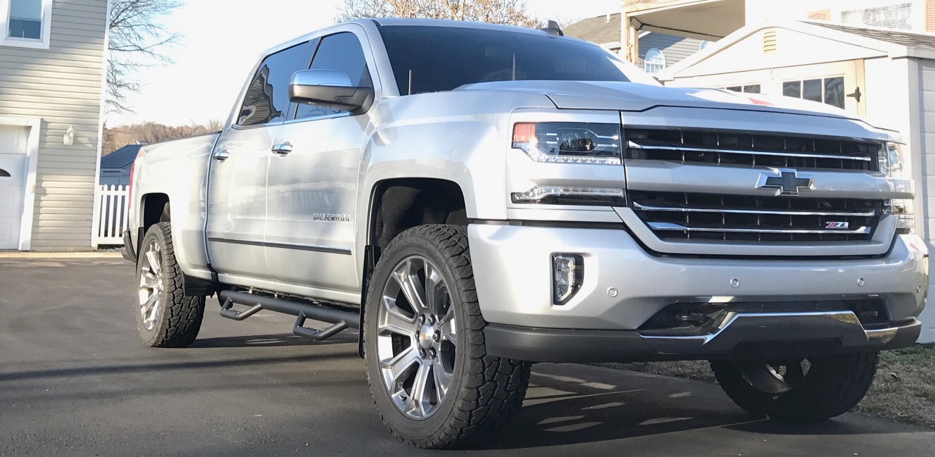

Here's my 2017. 2 inch rcx level with firestone airbags in rear. 305/45r22 hankook dynapro on factory 22s attachicon.gifIMG_0218.PNGattachicon.gifIMG_0217.PNG
Good looking truck
