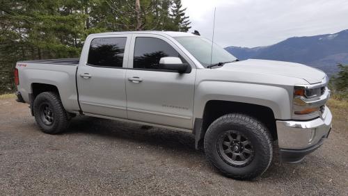

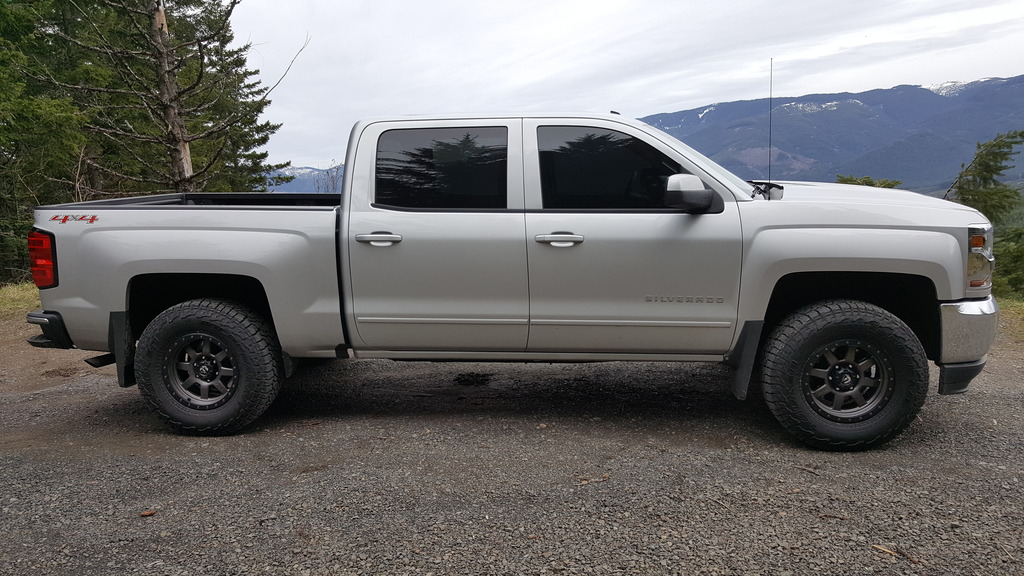

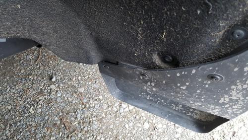

I already posted in Wheel / Tire thread but I figured I'd post it up here as well. Fuel Trophy wheels 17x8.5" -6mm offset and Tires are Falken Wildpeak AT3W 285/70R17 ( 33x11.5" ). I also installed a Rough Country 2" leveling kit. There was slight rubbing on front drivers side at full lock in revers. I used a zip tie to pull back the inside corner of the mud flap and now there is no rubbing at all.
