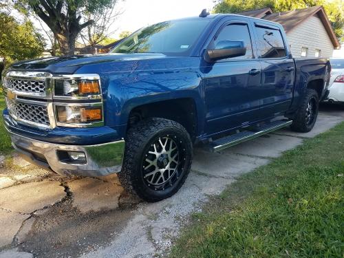

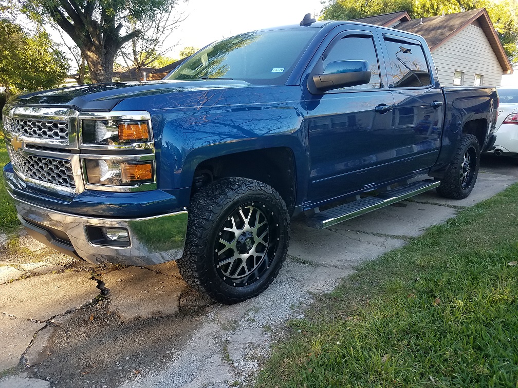

Finally bit the bullet last week on tires. I ended up going with the Falken Wildpeak A/T3W's, and I will say in person they look better than expected. For the price, its hard to argue against them. They are very quiet and smooth, and the truck rides exactly like it did with the stock tires.
I went with the 305/65/18s because 285s look so tiny on these trucks. They measure 33.6x12, and somehow I dont rub at all with zero trimming and a 2" level. Here are before and after pics. I will eventually post better pictures, because these dont do it justice. It looks beefy in person.

Those look awesome!

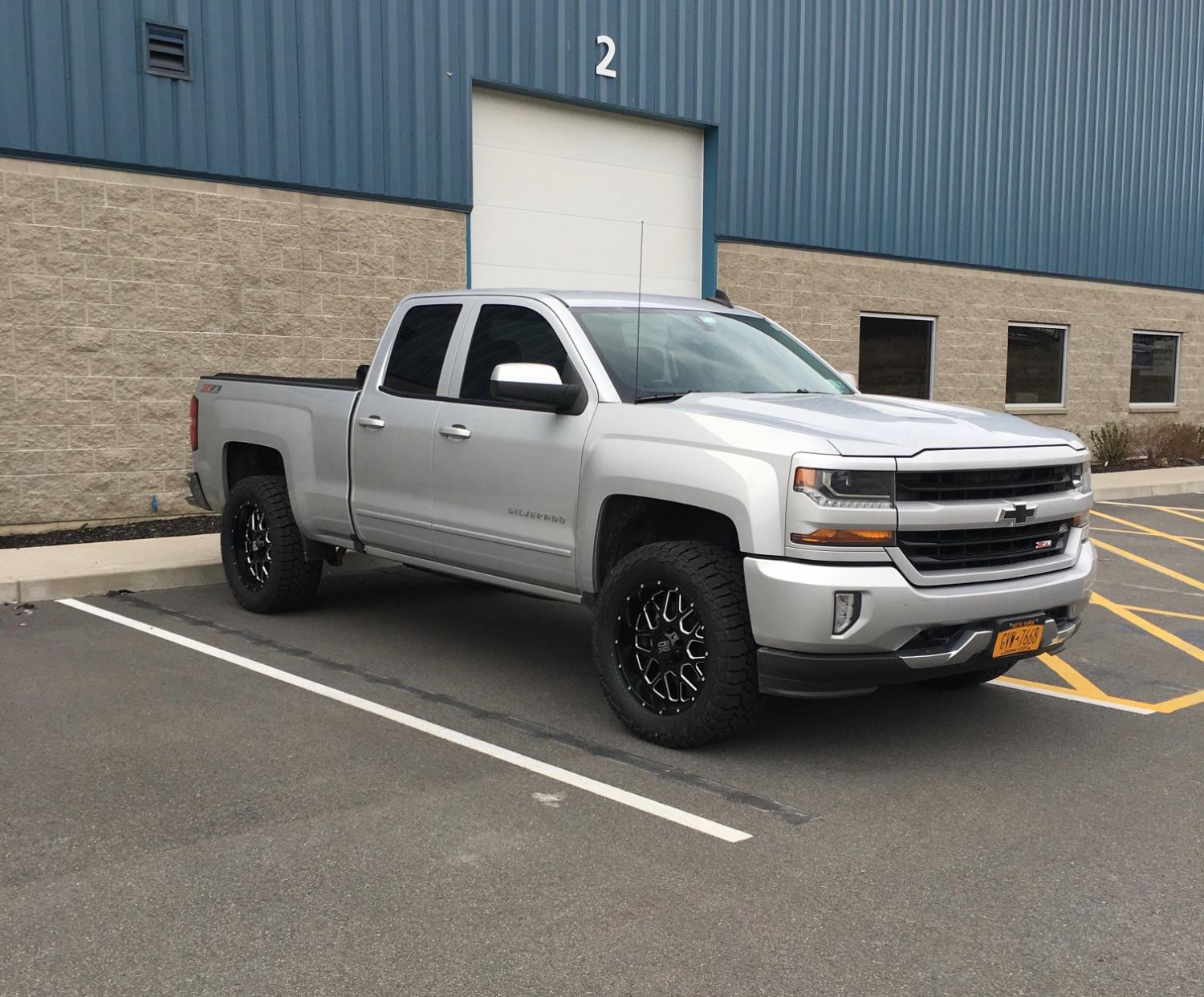

2" RC front level
XD Grenade 820 wheels 20x9 +0 offset
Falken wildpeak at3 tires 305/55/20

Truck looks great, did you have to any trimming or do you have any rubbing going on with the new setup. Looking at doing a similar setup on my truck.
