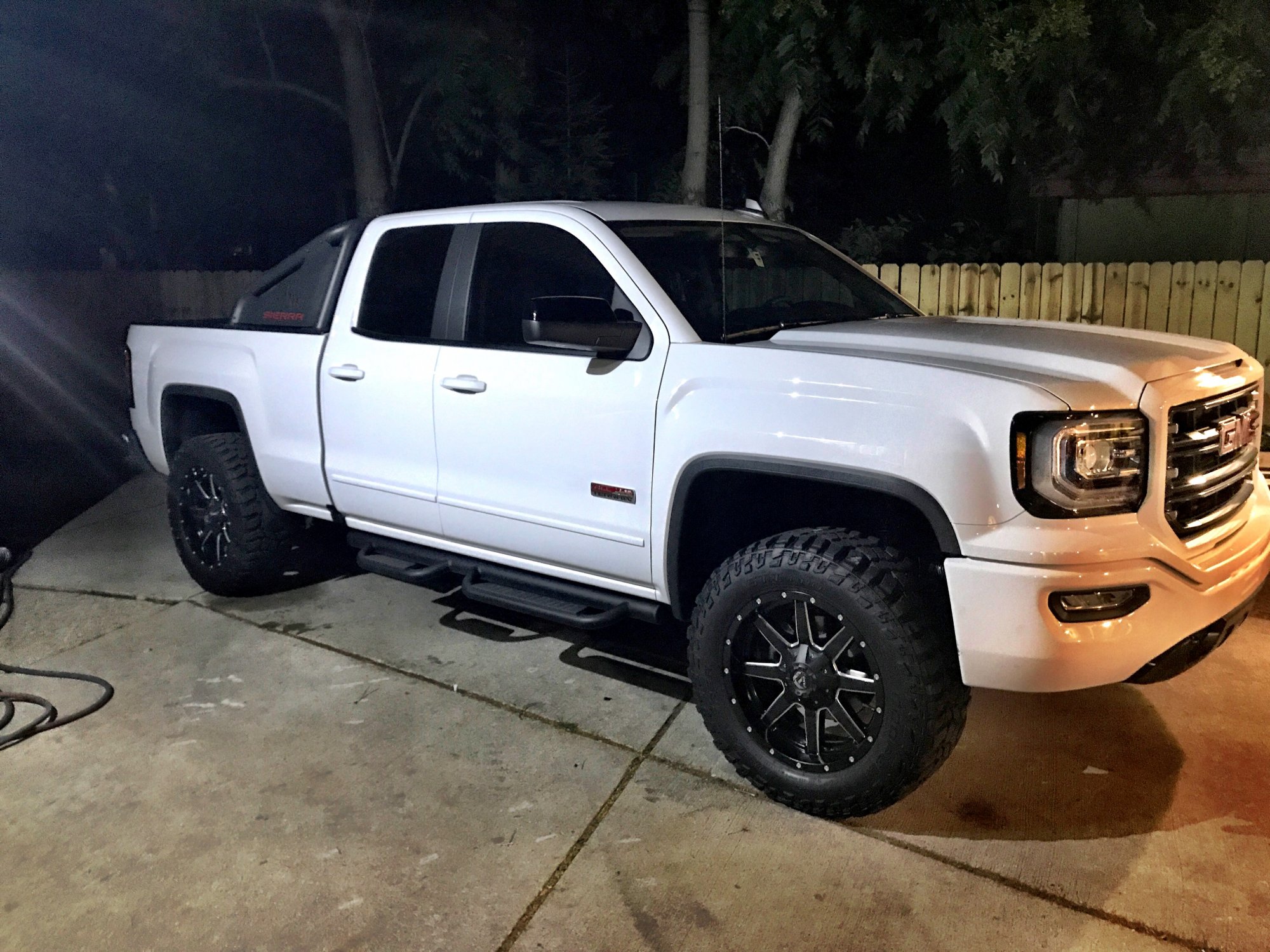

Rough Country 2.5 leveling kit on current truck with 295/60R20 Cooper STT ProSierraATX.thumb.jpg.d520e189ea8d2caabfc17b176d7b7e1c.jpg
Curious, What’s the offset on your Mavericks to fit that 34” tire?
The offset is +1. They rubbed on the carpet material in the wheel well but I trimmed it back, did not have to trim any plastic or metal
