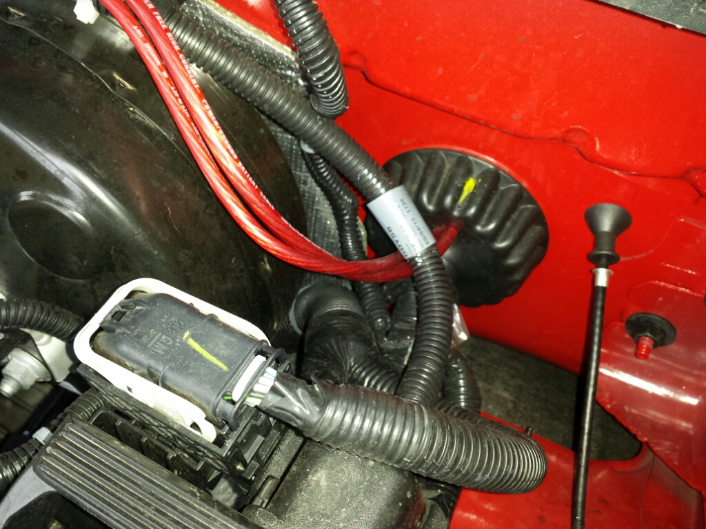

I have always ran my power cables thru the driver's side firewall, but it seemed impossible on this truck. I ran my 0 ga. cable thru the passenger side firewall since there was plenty of room plus the battery is on that side. I usually use the 3 piece waterproof grommet from stinger, but I was impatient and used a regular grommet plus some sealant to keep the water out.

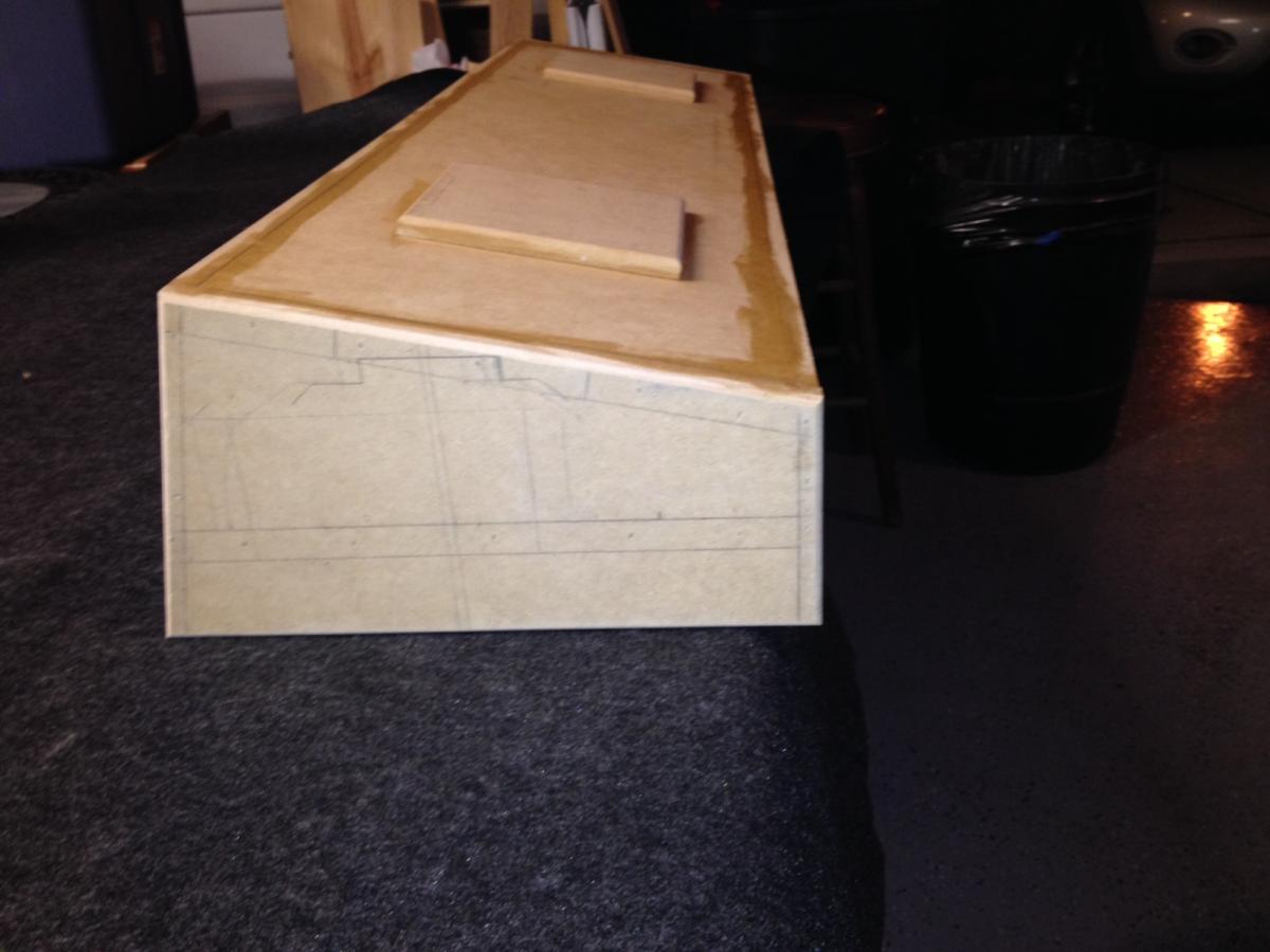

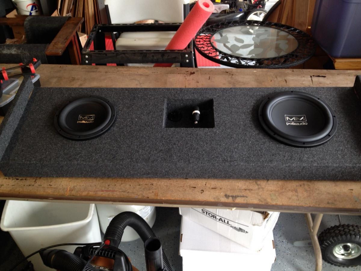

Here are some pics of the sub box I built for 2 Polk Mobile Monitor Subs - 8" MM840DVC and 10" MM1040DVC. I built it to Polk's recommendend volume and it sounds awesome.The chamber for the 8" is 0.35 cu ft and the 10" is 0.66 cu ft. I don't like the normal speaker connection plates since they can leak air, so I used Neutrik speakOn connectors. They are kind of pricey and normally used for pro audio, but I really like the quality and easy quick-disconnect without worry of shorting out. I forgot to take a picture with both connectors installed.
There's room right here in the stock grommet.
I thought about that, but it seemed too difficult with 0ga wire.

Wire lube or dish soap.
When I said I thougth it would be too difficult, I was actually thinking how to route the 0ga wire behind the fuse/relay box. I'm glad I ended up going on the passenger side because my wire wouldnt have been long enough. I will say your way looks alot easier though.
I pulled 4ga through the grommet on drivers side it wasn't easy by any means. I unscrewed the relay box from the inside of the cab which roped a bit that and lots of lube!!!

On the passenger side of the firewall, there is a rectangle area where there is no insulation, presumably for added options. (A) is the power wire. I used the bolt (B) as a reference point, then drilled with a unibit from the cabin side of the firewall.

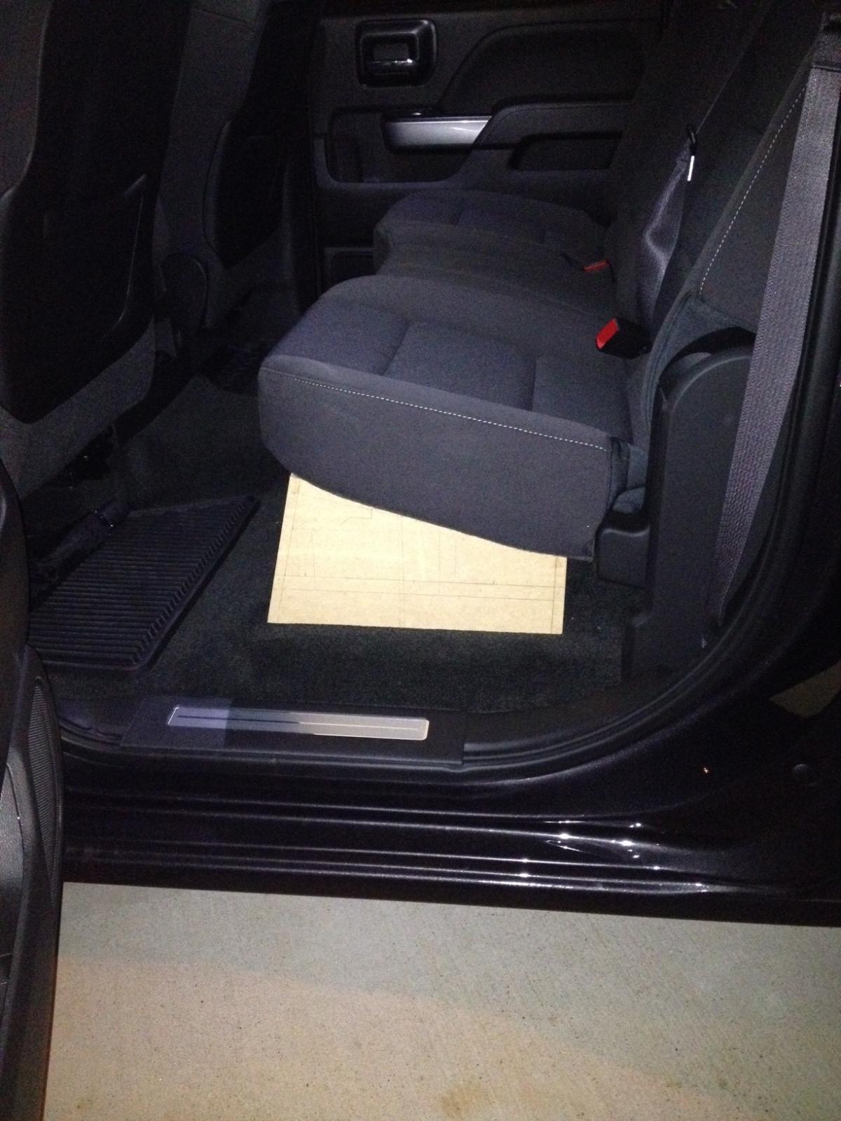

Has anyone built an enclosure for behind the seat of a Crew Cab w/ Bose? I have an existing enclosure from my Tahoe (placed behind third seat/gate and I would like to re-use it if possible. I like the idea of behind the seat because I can still access the storage under the seat if needed. However, it doesn't look like there is a ton of space behind the seat to do this. Any dimensions, insight or whatever would be great. Thanks!
