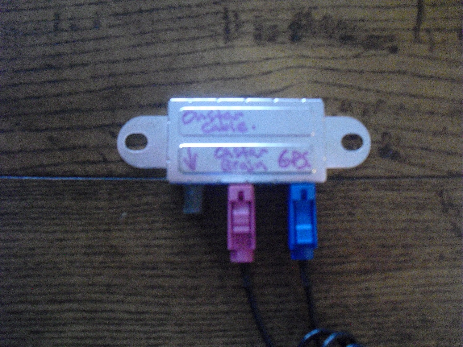

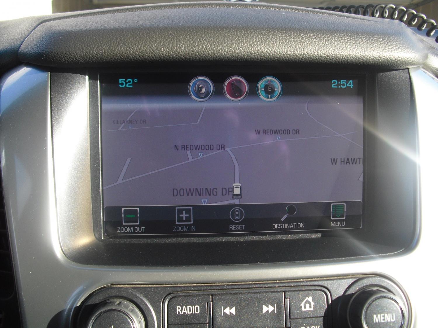

I ordered an upgrade from Kodiakz and it arrived 3 days later. Super easy install, took me about 20 minutes total. I did not, however, want to add a separate GPS antenna. So I ordered a GPS splitter from Greg at CPS Audio Video. That made the install even easier and while it wasn't what I would call cheap for a small piece of equipment it was worth it. Navigation worked right out of the box as did weather and sending navigation through Onstar. I was ready to have to deal with both but I'm grateful I didn't have to.
How much did the splitter cost?
The one I got was $90 + shipping. Like I said, a little on the pricey side but makes for a factory looking install. Very easy too, just unplug the lead coming into the Onstar module behind the glove box and plug it into the splitter. Maroon cable goes back to Onstar, blue goes to the HMI. This video is where I first found it and shows exactly what to do, https://www.youtube.com/watch?v=ckhBmuGfKRI
Greg at CPS needed my VIN to give me the correct splitter, so there could be ones that cost less or more or the splitter may not even be an option. I think your best bet is to send him an email to get pricing. [email protected]
After a day of using the system, it's still working great! My wife is very happy with the upgrade as she is directionally challenged.
Happy to have found this site. Just purchased a new 2015 Colorado and the only option it was lacking that I wanted was Navigation. Mr. Kodiakz is sending my solution to this problem. I requested the GPS splitter and he has that as well. I am just hoping that I do not have to screw with Onstar and XM like Aaron.
