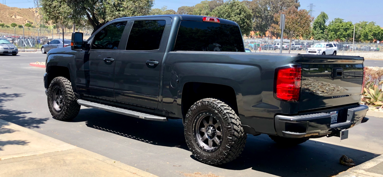

I have a RC 5 inch suspension lift + a 1.5 inch Zones Body lift with 20x1x0 -18 Fuel D 611 and I'm told there will need to have some cutting done. I am currently running 33x12.50x20 TOYO AT's

the offset is what's the issue (as far as cutting - because those wheels look awesome).
My '14, I had a 6 inch RC with 22's -44 running 35's.  Had to cut a pretty good chunk where the mud flap would go, angle out the front valance, and zip tie the wheel well liners
