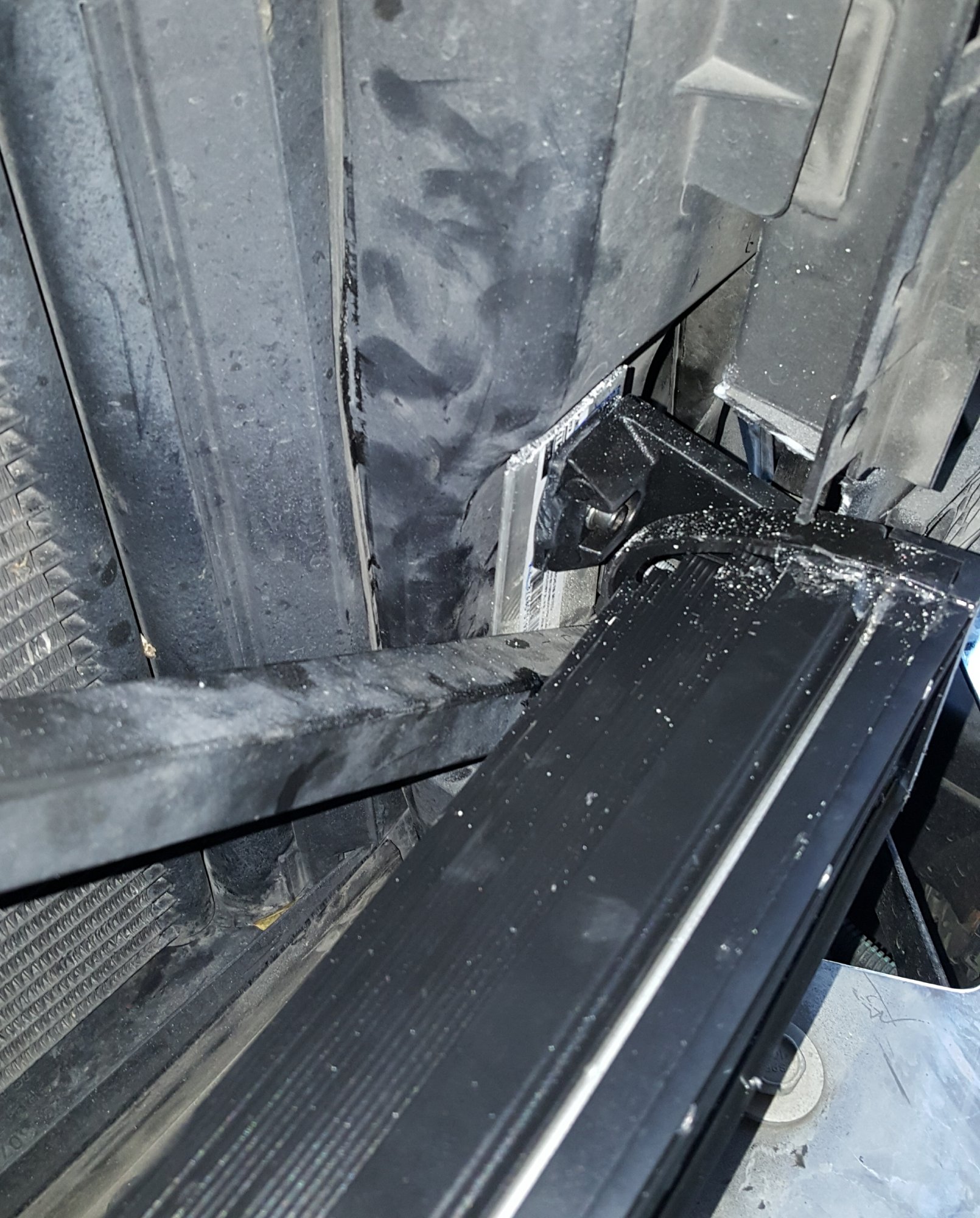

On 1/27/2018 at 10:17 PM, DirtyMarcus said:
Installed a 42" curved bar behind the grille. Took some cutting and rigging and removing the entire grille and supports, including whats shown in the picture below.  All in all there were about 30 or more bolts to remove, misc. wiring, hood latch, and headlights.  I couldn't upload a better picture because photobucket charges and the site doesn't allow over 4.8mb pics to post.  It took about 6 hours of time, start to finish to do properly, but I like it.
I just ordered 2 40" light bars, think I can install both behind the grill of my gmc?
2 hours ago, OUSux said:
Will a 40" light bar fit?
I think a 40" would be cutting it close with the sides
I doubt it if the GMC is laid out like the Chevy, behind the grille.  42" is the max I could fit width wise and only one.  The reason I could only fit one behind the grille is that the hood release is in the way up high and there's no relocating that.  You cant really tell but i disassembled a lot of stuff to get that one 42" bar in there and did A LOT of measuring and  trimming on the radiator deflector that connects to my grille.  It wasnt hard but time consuming for sure.
