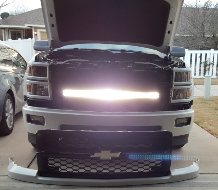

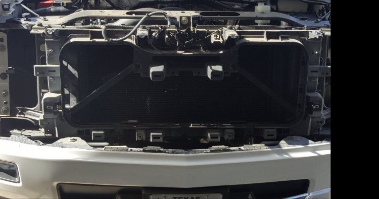

Installed a 42" curved bar behind the grille. Took some cutting and rigging and removing the entire grille and supports, including whats shown in the picture below.  All in all there were about 30 or more bolts to remove, misc. wiring, hood latch, and headlights.  I couldn't upload a better picture because photobucket charges and the site doesn't allow over 4.8mb pics to post.  It took about 6 hours of time, start to finish to do properly, but I like it.
Looks great. Sounds like a big job to install a light bar with taking off the grill. You got great results.
