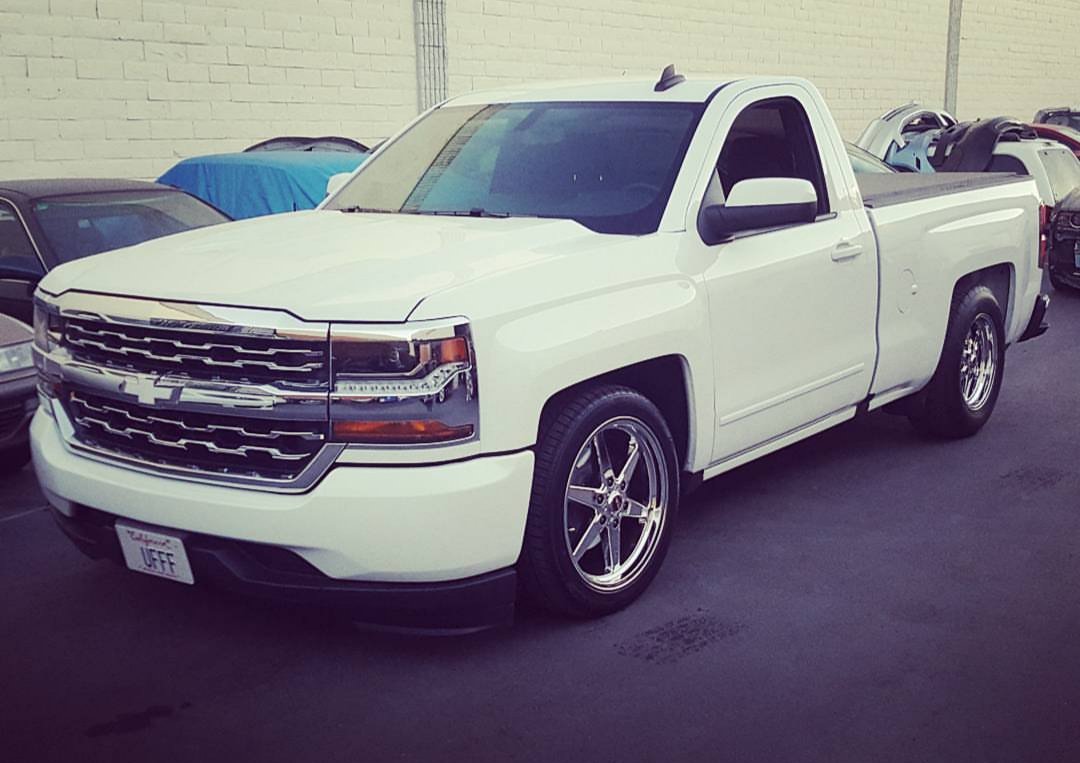

I have 17s with mcg spindles
We must have different spindles or something, there is no way I could get a 17 on mine. I've been meaning to ask about your setup because I wanna run smaller wheels at the track.
Sent from my SM-N950U using Tapatalk
I have the cast arms. Maybe thats it i do know a guy with a 17 crew cab. Stamped steel arms and he has to use a spacer in the front with a 7 wide wheel and his clears
Sent from my SM-G955U using Tapatalk
