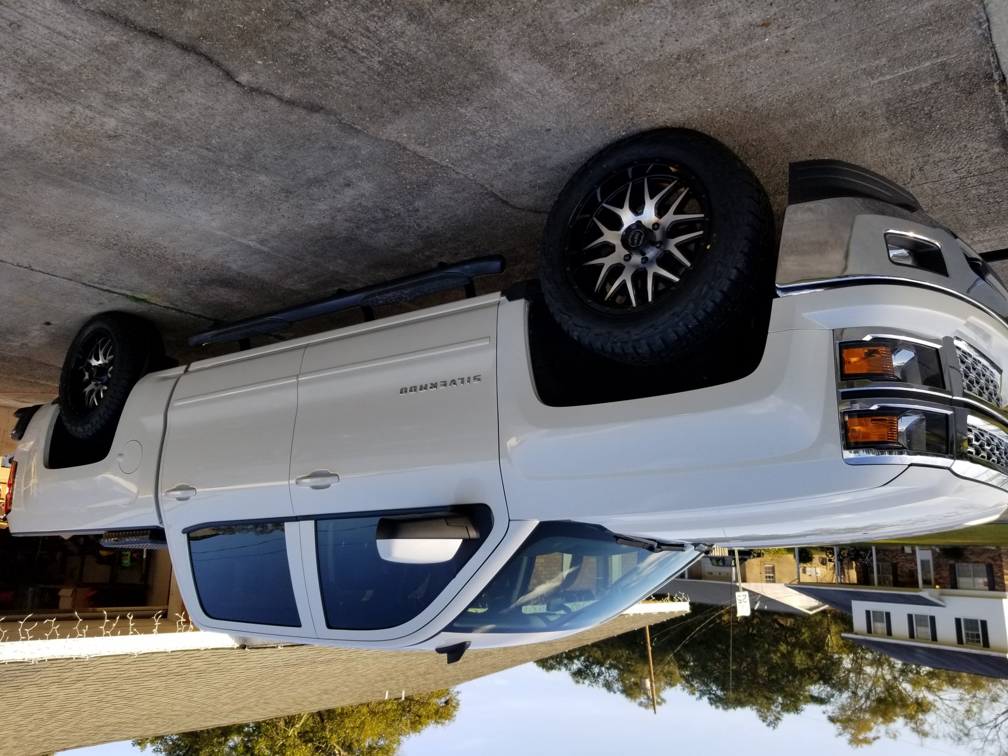

Does anyone have advice on lowering the rear end on a 2015 Silverado 4x4. I would be towing a boat on most weekends, is this a variable to consider when lowering the rearend?

I just would like to level the truck by lowering the rearend.
Sorry it's upside down.
