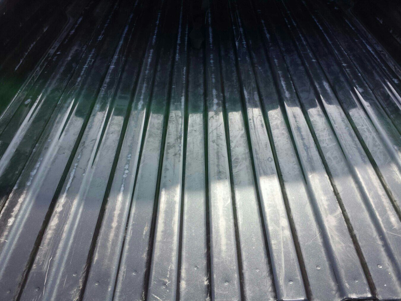

After 10 years with a plastic liner
Were do u live. Here in NJ drop ins aren't the best route. I have a liner in mine and will be removing in spring to Linex.

10 years with your drop in liner. I'd say that bed looks great. If you were from the north east it probably be a lot worse. All the road salt out here wreaks havoc on our beds.
