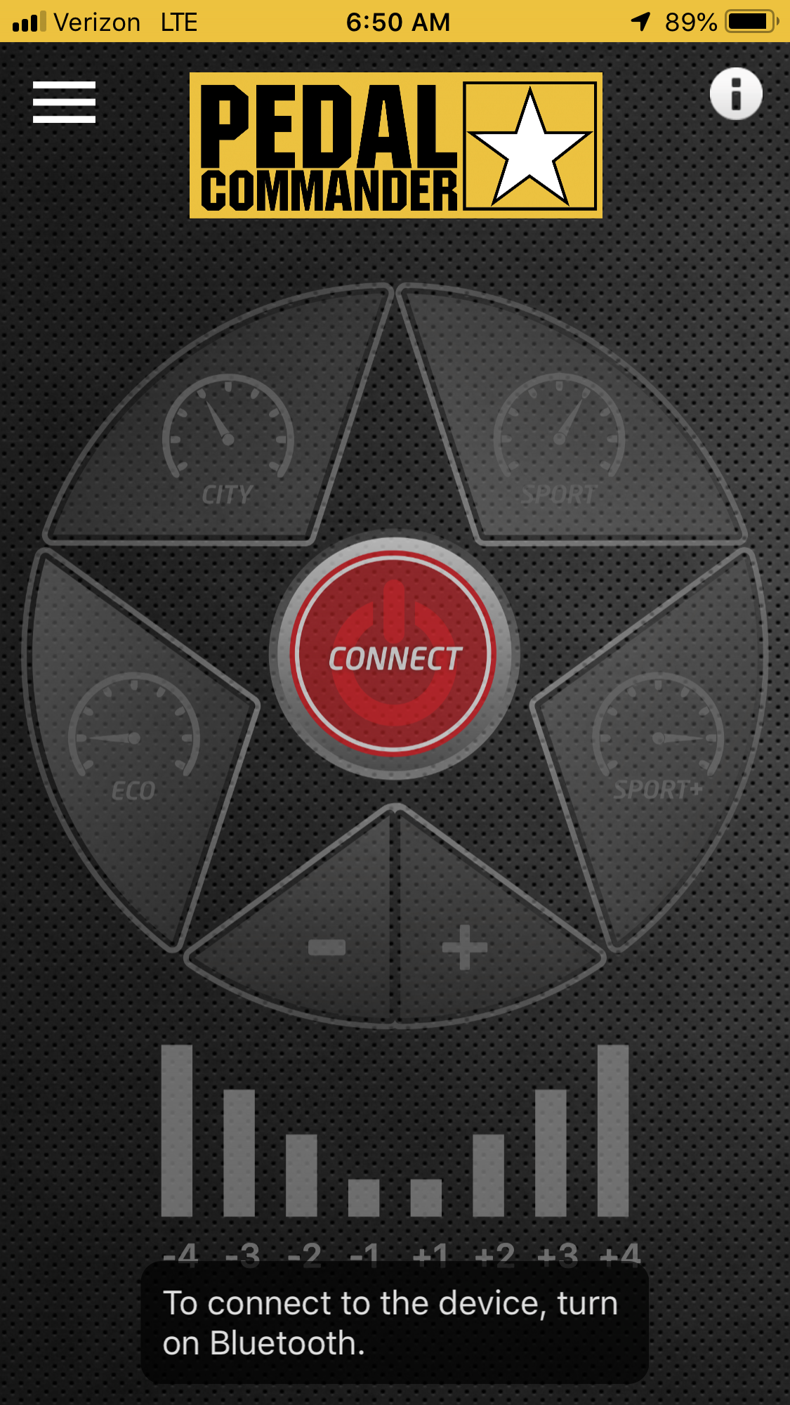

Flog away...I installed the Pedal Commander. Works great and yes I know all the reasons why it’s a waste of money but I’ve pissed away a lot more on a meal.

Pictures, how hard, price?

Pictures...no because I have it all tucked up and hidden. Here is a picture of the app. It is as simple as it can be. Unplug pedal harness, plug into Pedal Commander harness, then plug the other end of the PC harness into the gas pedal. Find a place to hide it or it comes with a Velcro patch and bracket (like the old pagers used to have) to mount inside/dash area. I got mine off Amazon, $279 with overnight shipping free. They actually got it to me over night too.....USPS has NOTHING on UPS. I will say that I did wait for about an hour after I shut the truck off before I disconnected the pedal harness, it says to wait 15 minutes to ensure all the systems are shut down so you don't kick a CEL. If you have a proximity system, it tells you to leave the Fob 30 feet or more away so it doesn't wake up the system as you're about to disconnect something. I have tried to get it to fail but nothing I have done has caused an issue. Lastly, it does not work with Cruise Control on (which I like) so after you have fun getting to a cruising speed, just engage CC and the throttle acts stock until you kick CC off. There, long post but you asked...I've been trying LOL I was gonna be a smarta$$ and answer you like this:
No, easy, <$300

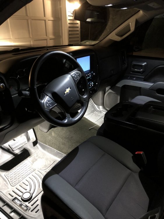

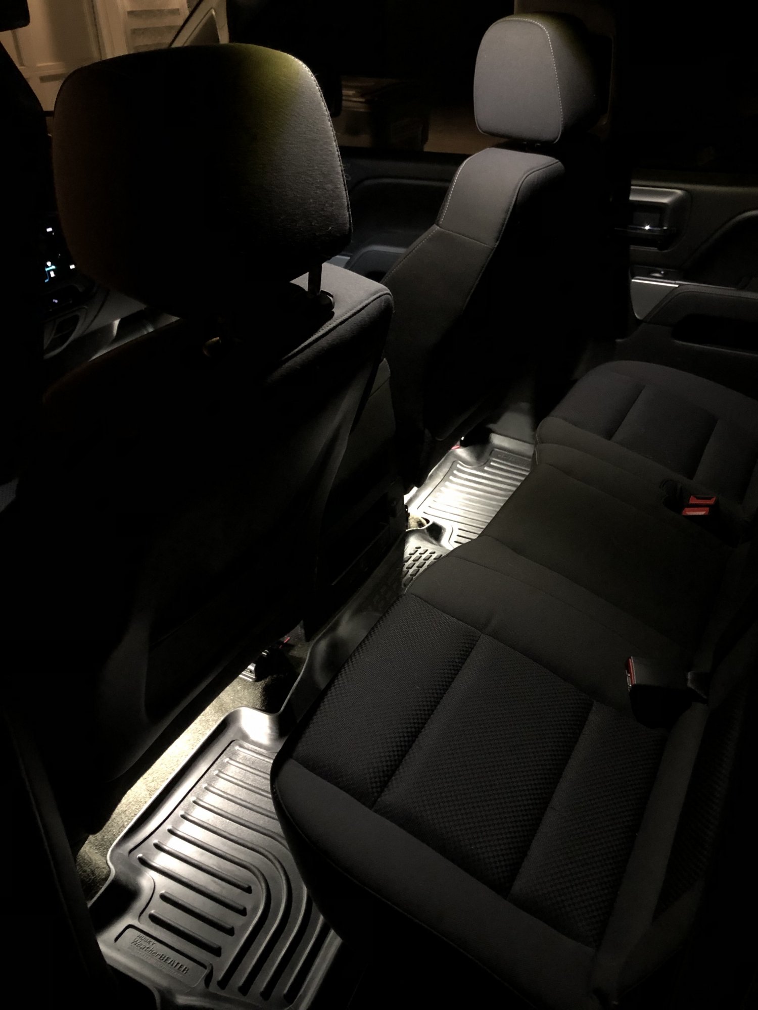

Installed some footwell lighting this morning in 25°F weather. Super happy with the way it turned out. I tapped into the dome light wire in the BCM so they dim on and off with the doors opening/closing.
I used this kit from Amazon for $15.99. The modules seem to be of really nice quality and come with 3M backing tape and hardware to mount; plus 16' of wiring harness.
Now I'm planning on using the remaining eight modules in the bed, but I'm not sure about where to tap into -- any advice? I've seen some tap into the reverse lights so they come on when unlocking the truck and others buy the wiring harness for the factory lights...can I tap into into something that is always on back there and mount a switch somehow? Thanks for any ideas!

You can tap into the trailer harness under the rear of the bed, that's what I did. How did you mount those under the front seats? I like that
