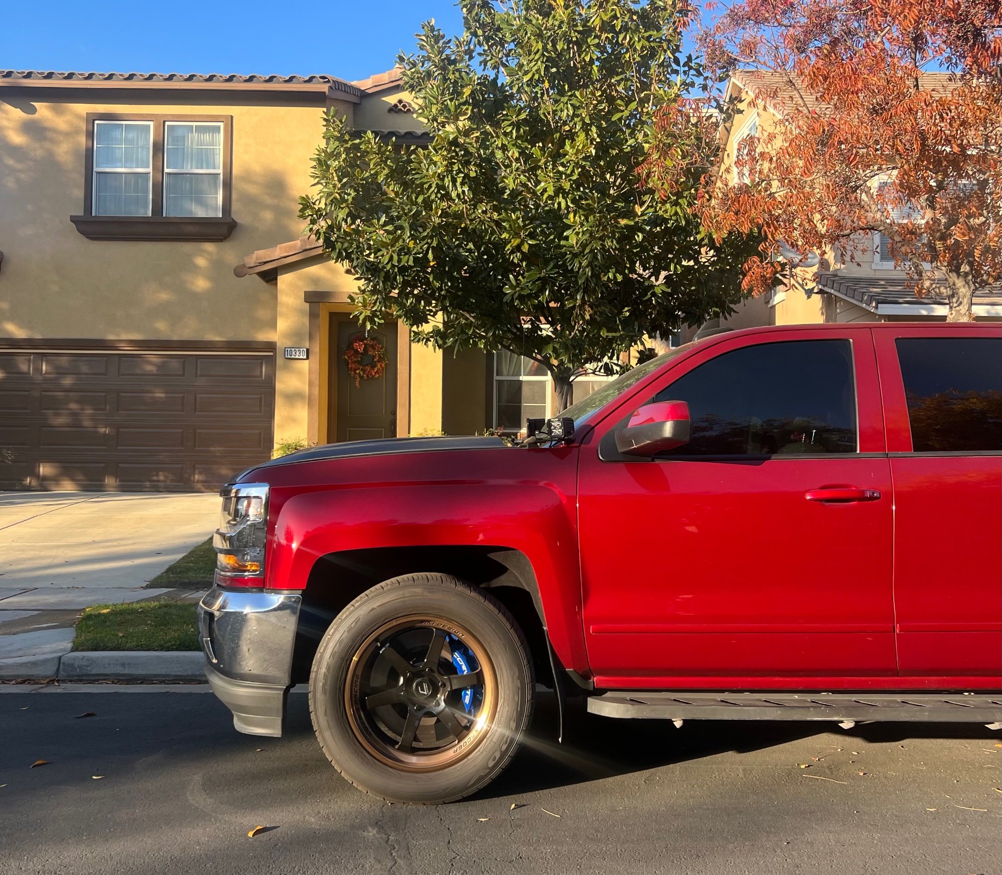

Excellent info. I see that @jpinoy had 22" tires with a recommended psi of 35 and I'm guessing that the max cold pressure was probably 50lbs psi so recommended psi was at 30% under max. From what I saw for specs on the Firestone Destination X/T that he has is that they are LT Tires with a max cold pressure of 80lbs. 35psi would be way to low and even at 45, looking at the tire, it's visibly still too low and will end up wearing out the tread on sides quicker. If the max cold is 85, if it were me, I would increase to 56psi and use that as a starting point and then do the chalk test. 56psi would be 30% of max.

Yeah, max load 3305@80psi cold is what is on the tire. I used this site to convert from OEM to new tire, and it states 45 psi. But that would be based on the load, since max load would be 3305@80psi. Max psi on my OEM tire stated 2337@44psi.
https://tirepressure.com/tire-pressure-calculator

When it stops raining and time, I might give this a try. Saw some YouTube vids on doing it this way.
Rock on. Tire pressure has always been hit or miss due to the wide amount of variables.
This method along with 3k rotations will help get the most mileage out of the tires.

Agreed. Even that link mentions load variable plays a roll in your tire pressure.
Hmmm 3k rotations, I'll have to give that a try. Always just did it per maintenance schedule.

Yessir. I've been a fan of 3k tire cross rotation since youth. Nothing more satisfying then seeing tires wear equally.

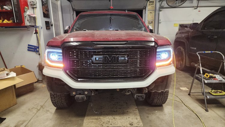

Finished installing wiring for Denali LED headlights and test fitting body parts on my 2014 All Terrain. It is now ready to be sent to the body shop for paint.
