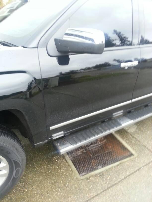

I removed the Sierra lettering off of both doors and SLE from tailgate. It took me an hour to remove one side and about thirty on the other. It was warmer outside with the latter door and the adhesive came off much quicker. As far as the badge on fender, I haven't decided yet. I will say that with a black truck the lettering outline is still visible if you really look for it. Any ideas on how to get this off? I used turtle wax adhesive remover and it worked fine.
Clay bar it, then use adhesive remover again. After, wash & wax the area.

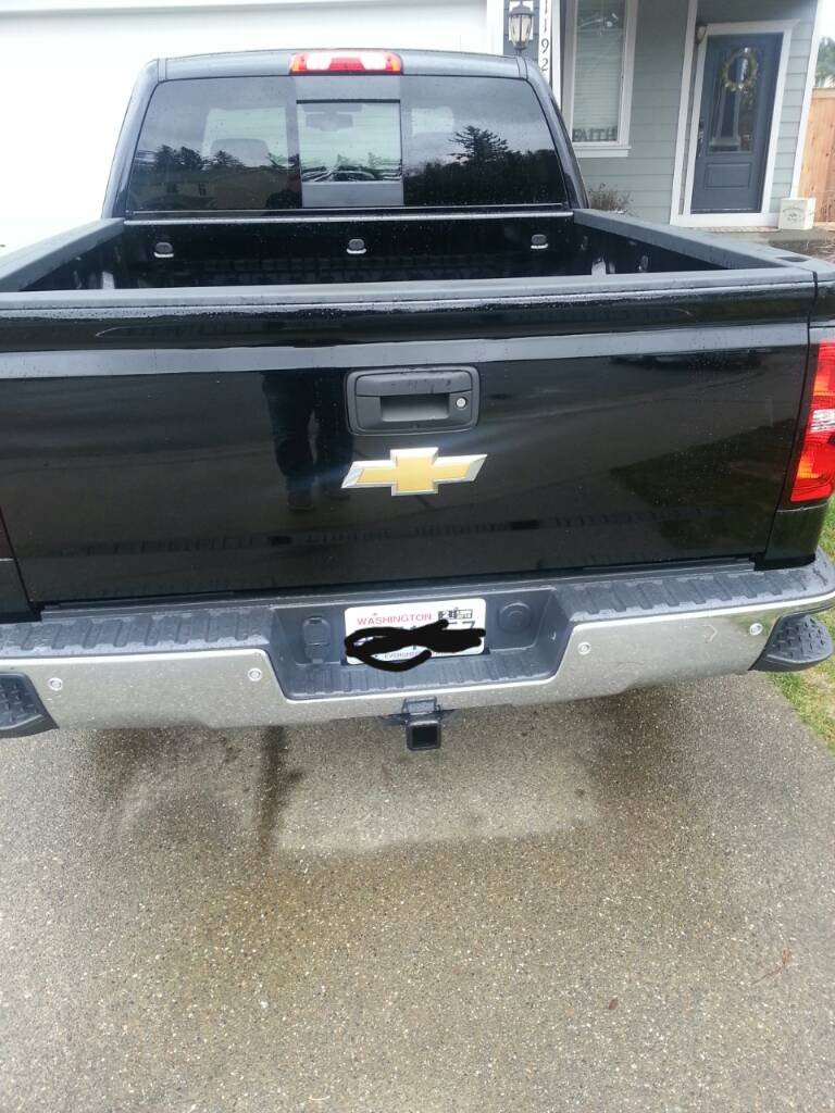

OK, I just finished de-badging the back of my truck. It took me a couple of days. Here's what I did.... I used fishing line to take off the SILVERADO and LT. Those were pretty easy. The left over double sided tape was easy to remove. I removed most of the left over with my fingers pretty easily. I then sprayed some goo-gone and it and it was clean. The difficult part was the Chevy bow tie. I used the ol' fishing line trick to take off the plastic piece, then I was left with A LOT of tape. And it was very difficult to get off! I was chipping away at it for a few days then I decided to get serious about it. I went to Napa auto parts and bought a eraser wheel ($13). I attached it to my cordless drill and went to work. IT WAS AWESOME!!! That eraser wheel makes it sooooo easy! I highly recommend that to anyone trying to do this. Good luck.
Clean tailgate
