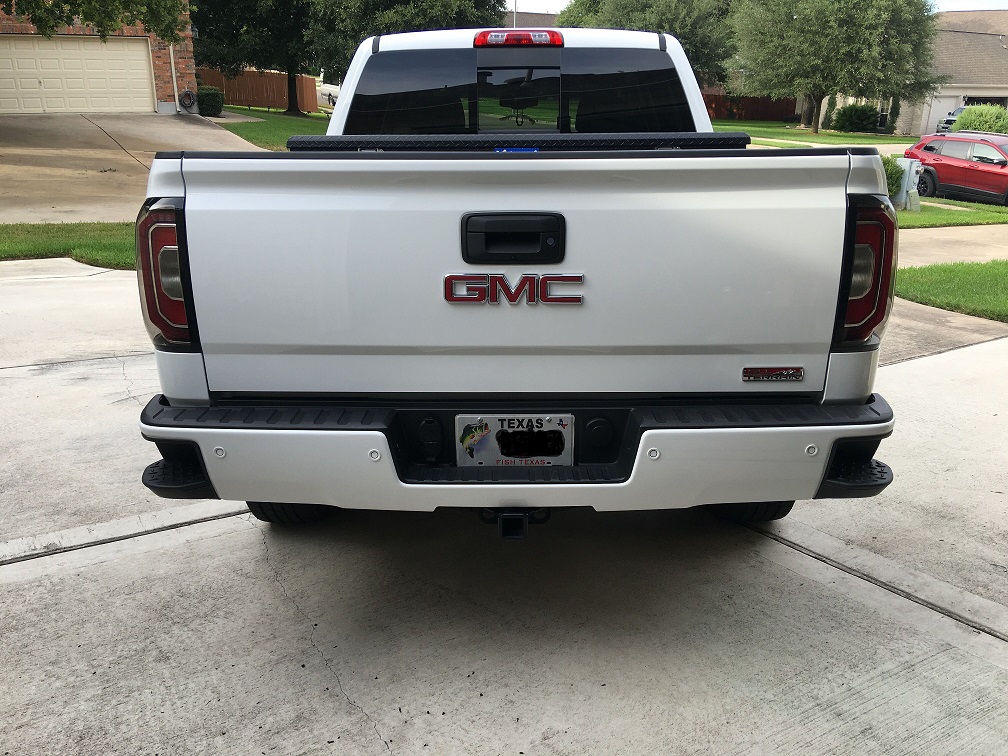

that was with Sierra removed from lower left... also took off the GMC and the AT badge... but left the AT badges on the doors..
much better..

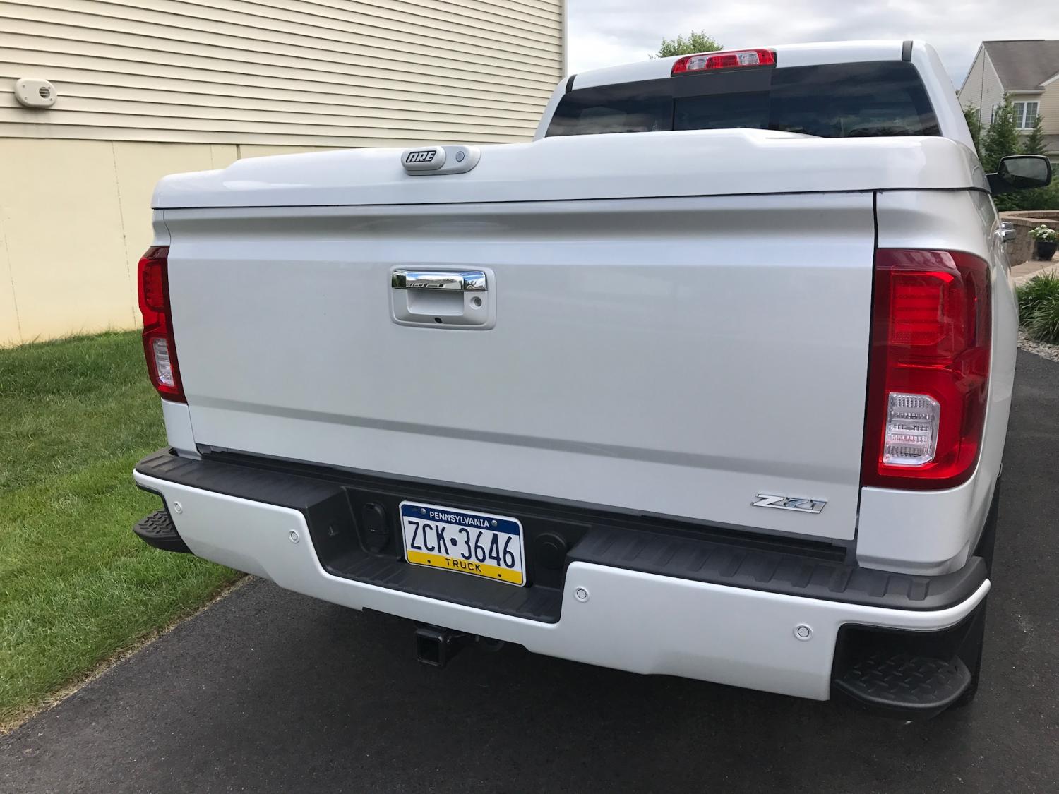

16 LTZ Z71 with everything stripped from the tailgate. I was able to peel/rub the tape off using some goo gone to help
After while I decided on the following as my final product
looks good

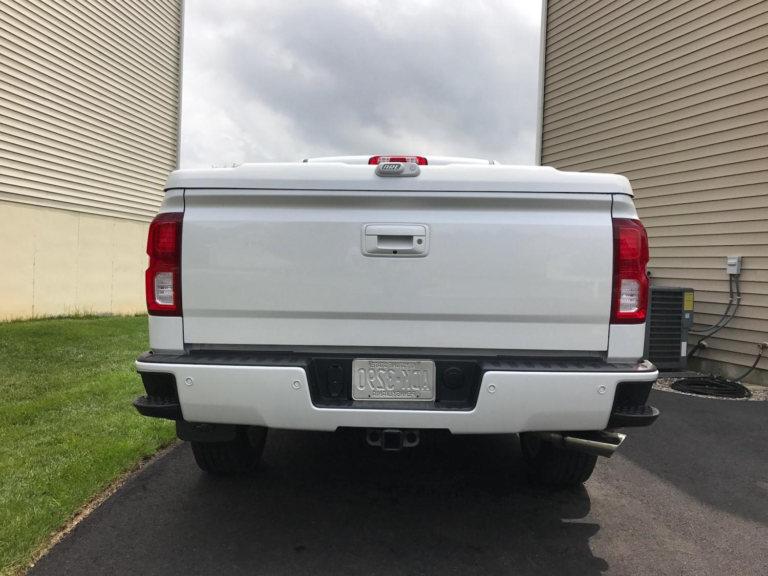

De-badged with CMd chrome tailgate handle
2017 Chevy Silverado LTZ Z71 6.2L
4.5" Zone
22x10 AF Grips
33x12.5 Nitto Ridge Grapplers
Instagram @wildchevys
post-162847-0-42504200-1506652302_thumb.jpgpost-162847-0-33209700-1506652324_thumb.jpg
The Silverado emblems from the doors and tailgate took about 20 minutes to remove and eraser wheel the tape off. The bowtie took about 20 minutes to remove then another 25 minutes with the eraser wheel to get that kriptonite foam tape off.
