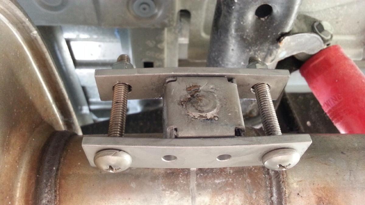

I wanted to hear how my truck will sound if I played with the exhaust adaptive valve, so I took a 2" clamp, turned the valve 90 degrees and clamped it really well.
It sounded nice when the exhaust was cold, took it for a short drive and noticed the tone got better when the exhaust warmed up, slightly louder, defiantly not a $1k exhaust catback sound, but hey, it's FREE!! or almost free if you don't have a 2" clamp laying around.
I'll leave the clamp for a few days, if I like the sound I might as well take that dumb valve off.
Thought about passing this tip for anyone who's considering a catback or leasing his truck, this mod is totally reversible.

UPDATE: I took my truck to a local exhaust shop and chopped off that valve, sounds nice! Not bad for $30.
What is the purpose of the flapper valve? Are there any negative effects removing it or locking it open?
It's there to quite the drone when the engine goes to V4, and also makes the exhaust slightly quieter but looking at how it's designed, it's very resrtrictive. The only effect of removing it is slightly louder exhaust.
