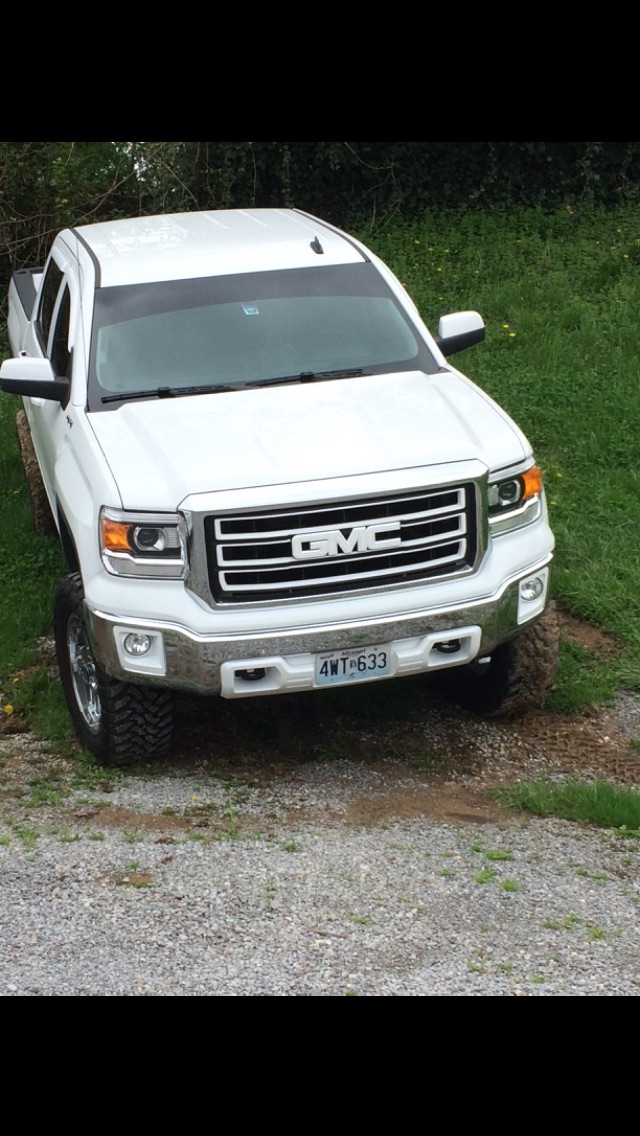

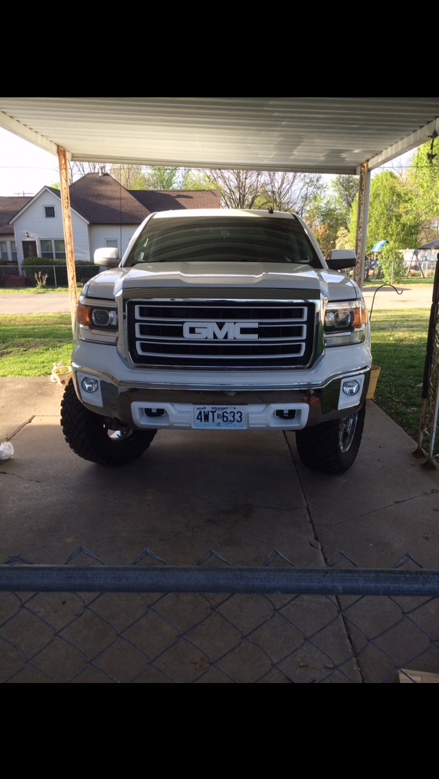

Hey guys. I just finished color matching the trim on the bumper and grill parts to my truck. I want to do the headlights. I would like to do them white but as someone said above it would be a lot of white. So what do you guys think would better to match what I have already done?. I was even thinking of doing them with white and black??
Could you post a picture with the truck in the sun for easier viewing?
Here ya go. It's not in the sun but it's out in the open.
