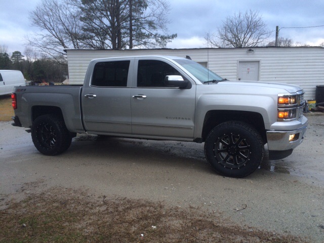

Thought I'd share my latest tire/wheel setup
2" Leveling kit
1.5" Zone Body Lift
20x10 Fuel 2pc Renegade -19mm offset
33x12.50r20 Toyo M/T
It cleared on flat ground, but was very close, so we did some minor trimming behind the front tire. No trimming to the front bumper. It may have never rubbed, but I'd rather be safe than sorry!

Looks good.. I have 20x10's ordered for mine so I was curious to see how they would look.

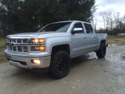

This is my 2015 Silverado ccsb I just put some Gear 20x10 -19 with Nitro Terra Grapplers LT305 55 20. Truck has a 2 in RC level.
What size are those tires? I don't want a level or lift. Looking at 275/70-18 or 285/65. Looks good.
