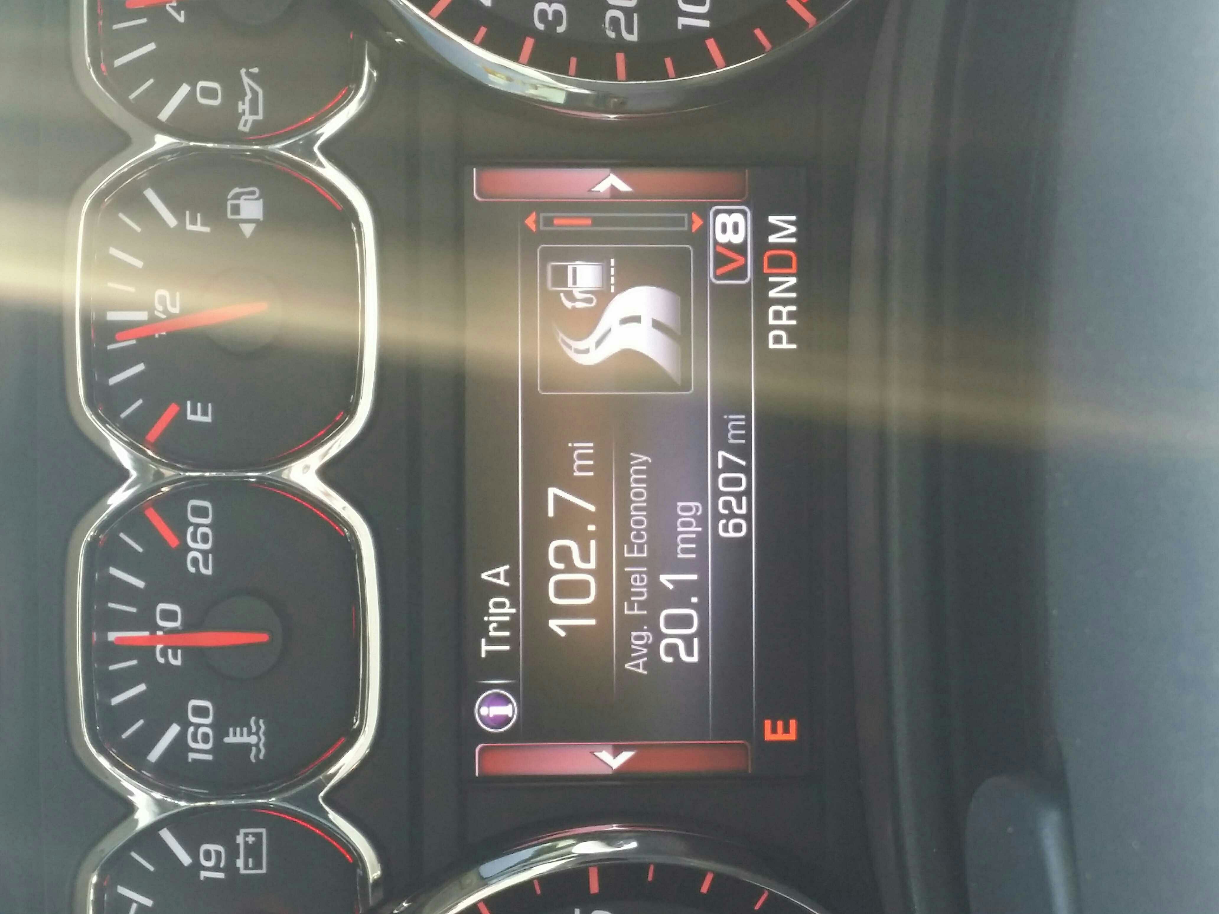

Took truck In for dic updates, now my display doesn't work... Mechanic said I'll need a new display cluster!?!? No loaner car... Extremely disappointed driving around in my brand new truck with a display that doesn't work....
Note this is a 2014 gmc sierra smh still waiting to hear back from my dealer attachicon.gifIMG_20140712_102152.jpg
im going to take a guess and say that the mechanic downloaded the wrong file or they previously did a chev and still had the chev file on their computer but havent yet downloaded the GMC version, or didnt realize the have different splash screes.
i have a Sierra and had this update done, i have all GMC logos and its all working fine as far as i can tell, there is most likely 2 versions of the update.
Just got my truck back all is normal in the world again figured they would chop up more excuses but they apologized and didn't take to long post-132060-140544726373_thumb.jpg
