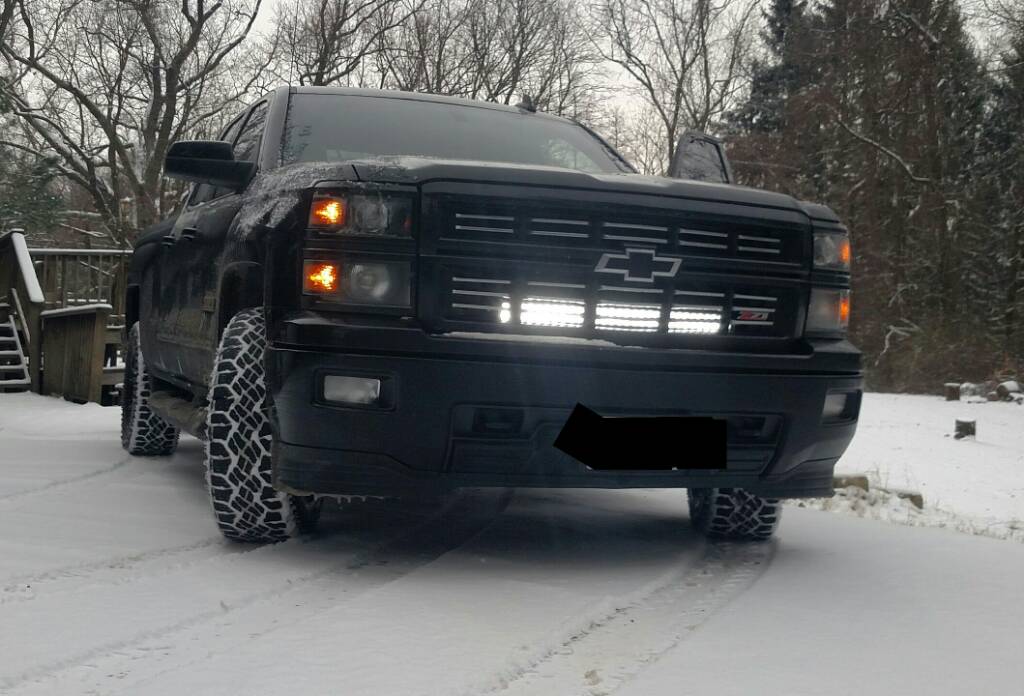

I just stuffed a 32 behind my grill yesterday. No shots on yet. Try to get some of that before the weekend:
looks good. did you mount to the radiator support ????
