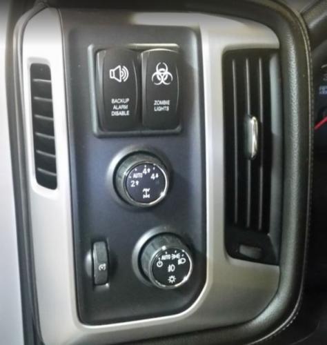

2. I powered mine off the battery, but there are 2 relays between. I've connected to a 3-way switch that allows on, off, or on with high beams.

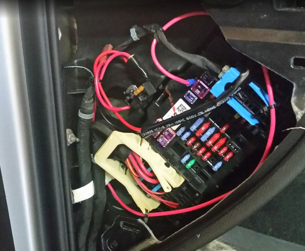

4. I grabbed ignition power from the fuse panel on the driver's side of the dash and added an in-line fuse holder.
Ignition power tap:
Switches:
