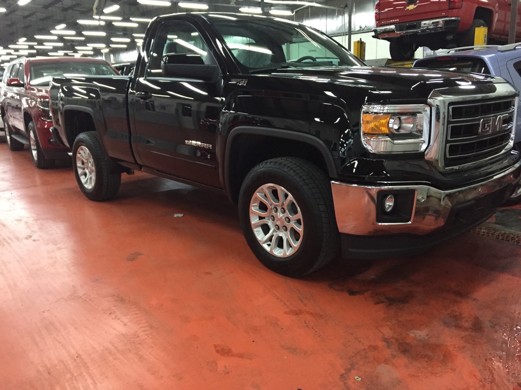

Hey Guys,
Receiving my 2015 in 2 days (pics attached). Wondered if anyone painted those rims bLack or any dark color?
If painted, what kind of paint do u recommend ? Do you think car wrap stuff would work on the rims?
Sorry for the newbie questions - I'm new to run color change.post-135840-141650188664_thumb.jpg
