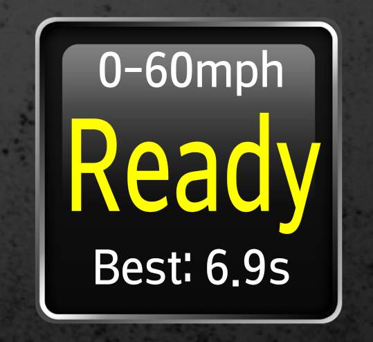

I know Diablosports is based out of Florida so they probably have a fairly consistent ethanol % down there for tuning. I've been reading about 69% with Speedway E85 here in MI. The new tune felt nice today, was able to do a little logging with the Torque app which I haven't looked at yet. Did get one 0-60 run in. 6.9 seems alright for my 2014 Dbl cab z71, 5.3, 3.08, LT285/70R17. Had a lot of tire spin off the line, I think I can do better. Recorded a 7.5 with a little wheel spin using the InTune logging last week.
