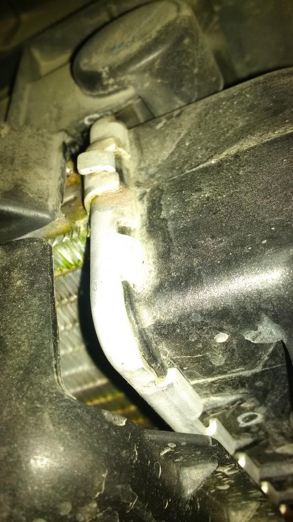

I did a search but only found heater core issues. Has anyone else noticed an antifreeze smell at the front of your truck when parked? Lately, when I stop somewhere and get out, I notice the smell when I walk around the front of the truck or open the hood. I have looked everywhere but can't find a leak. It doesn't look like the level in the overflow container has dropped so I don't know if I am just imagining things?

Sometimes radiators develop microscopic leaks that are very dificult to find. You will lose coolant slowly and the coolant level in the overflow bottle will drop. Look for signs of white powder deposits on the radiator core. These powder like deposits are a telltale sign of leaking coolant. Also, overflow plastic bottles have been known to leak. Some manufacturers seems to have chronic problems with those.
Also recommend you inspect the radiator neck area where the hose are atached. These plastic necks sometimes develop very small cracks that leak.
Thank you for the replies. And the link. Mine seems to be coming from the same area, I will have to keep looking.

I work as a GM tech and our dealership now keeps radiators in stock for these things. We have replaced at least 6 that I can remember. You can't see any leaks from the radiator even when pressure tested but once you pull the radiator you can see the coolant stains on it.
