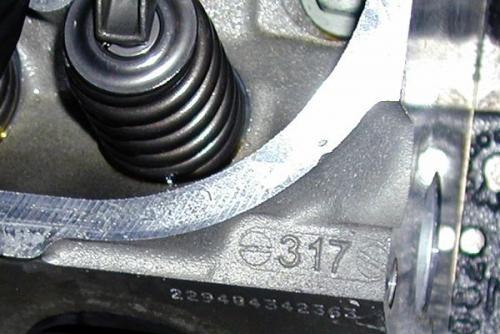

Also the heads on the exhaust side on top have a casting number. It can be seen with the valve covers on. Easiest one to see is passenger side and its at the front. 706 is the main casting affected by Castech. Here is a pic of what the casting number looks like

Just checked and mine is a 706 casting #. look on Jasper yesterday and they are priced at 2700- 3400 for motor.

My '04 with 134,500 miles just suffered the failed head issue. Haven't popped the valve cover to confirm I have Castech heads, but no matter I definitely have coolant getting into the oil. Blackstone Labs oil test showed this and changing the oil just the other night showed how bad it is. Black sludge came out of the drain hole, and the catch can I run on the PCV hose was FULL of coolant and gunk. My heads are 862's, so I think various castings are susceptible.
