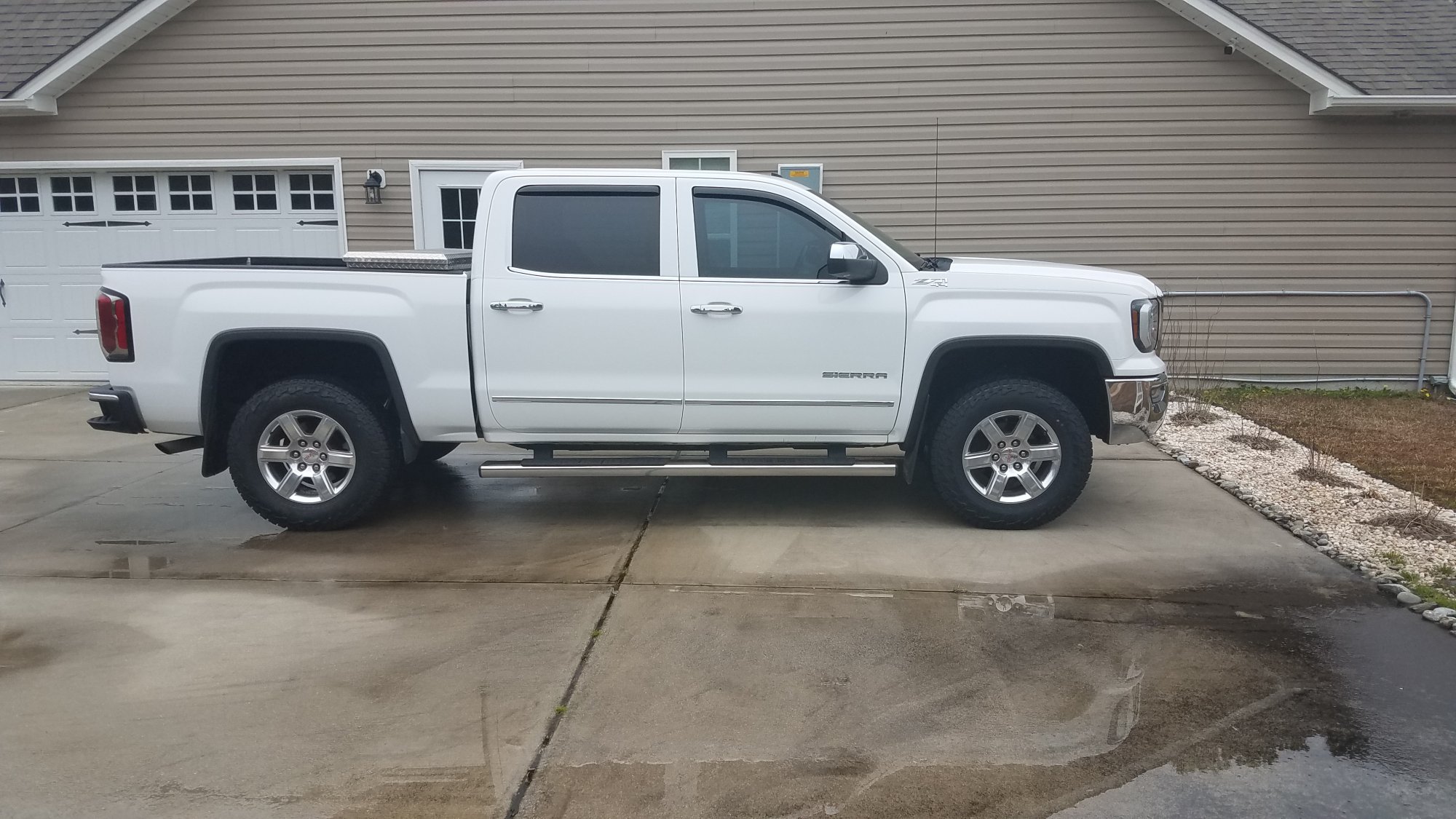

5100's on all 4 corners and the front on the top notch. 265/70r18 wild peaks.

Went to the shop to get a quote and an appointment to get my 5100 installed on the front of my 18.  Was quoted $315 for install and alignment... I just hate that I have a lifetime alignment with firestone.  The plus is this a a good shop... Another negative is the appointment is 3/9...
So, just get them installed at the shop, and aligned at Firestone. Or find out how much Firestone will charge to install them, then align.
This isnt rocket science. It's just too dangerous to do without a wall mounted spring compressor.
Yeah. I will be doing that, i just don't want to to the spring compression

Finally got my 5100 on the front of my truck.  Took the struts to a machine shop... They used the old lock nuts on the piston rod instead of the flange nuts... Kinda pissed me off.  The machinist said I didn't give him the parts or instructions... He put the flange nuts on the 3 post screws and the instructions were oily.  I talked to him because he was pissed off when the manager talked to him... So then he says the flange nuts were not slas strong to him.  Then he says of-roading will void my warranty anyhow.  I Said, first it's for my safety and not warranty.  Just follow the instructions...
This is why I like to do my own work... Anywho..   I went ahead and put them on the truck.  I had them set to the second notch.  The ride is stiffer, but I will check them out more later.
