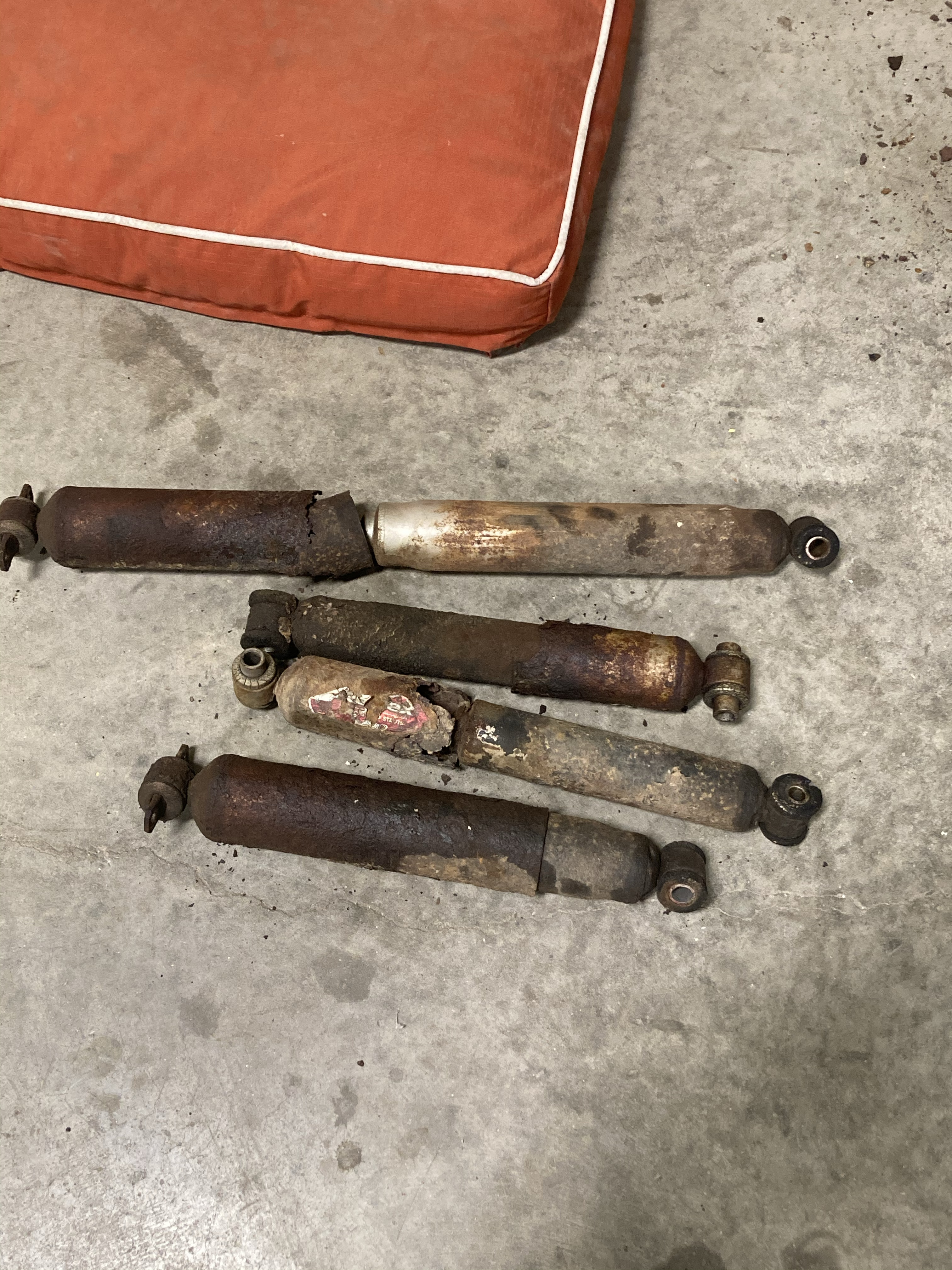

I got my rears from Amazon.  Still trying to find a set of fronts somewhere.  I have a set ordered, but they are 2-6 weeks out.  Did the rears a few days ago.  My truck has 90K on it, has never towed before ever.  The factory shocks were completely shot.  Everyone should be changing these at 75K or earlier.
