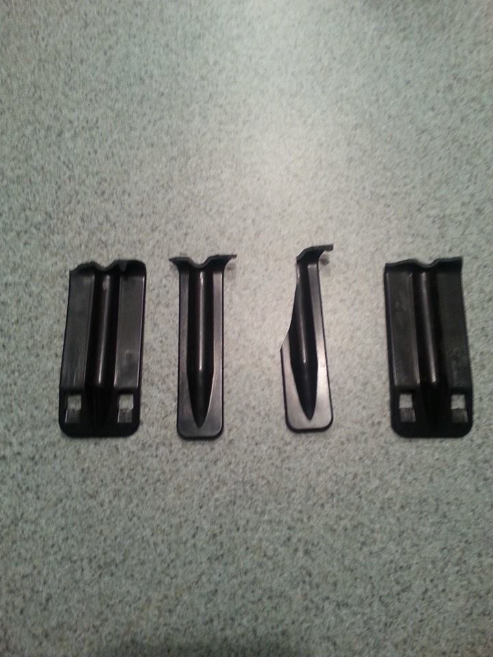

Cheap? Just wait until your dash starts cracking at the passenger side airbag...and GM pretty much tells you to pound sand. They claim there's not a problem with the dashes cracking, then they'll blame it on the heat, cleaning products, etc. My whole interior rattles like crazy...the panel at the driver's knees rattles and doesn't align with the adjoining panel correctly. The upper storage compartment on the passenger side also does not align properly and has about 3/16" or so overhang. Just recently, my back seat started rattling and making loud noises. I found the problem a week or so back...

What exactly are those pieces that you found in the back seat?
Those plastic peices (there are 3 on a crewcab back seat anyways), insulate the top seat back metal guides from the rear cab interior sheet metal. There are 3 metal tabs that the seat back slides up & down in when you open/close the seat bottoms.
I broke 2 in my 2009 & already 2 again in my 2012!! The back seat does rattle like crazy when these break!!
Our now 4 yr old & 6 yr old daughters ride back there- Anchored down in child seats. So it's not like they are jumping around back there!!
GM calls them "bumpers", PN# 22771139. But they really are a plastic insulator.
