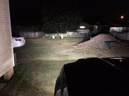

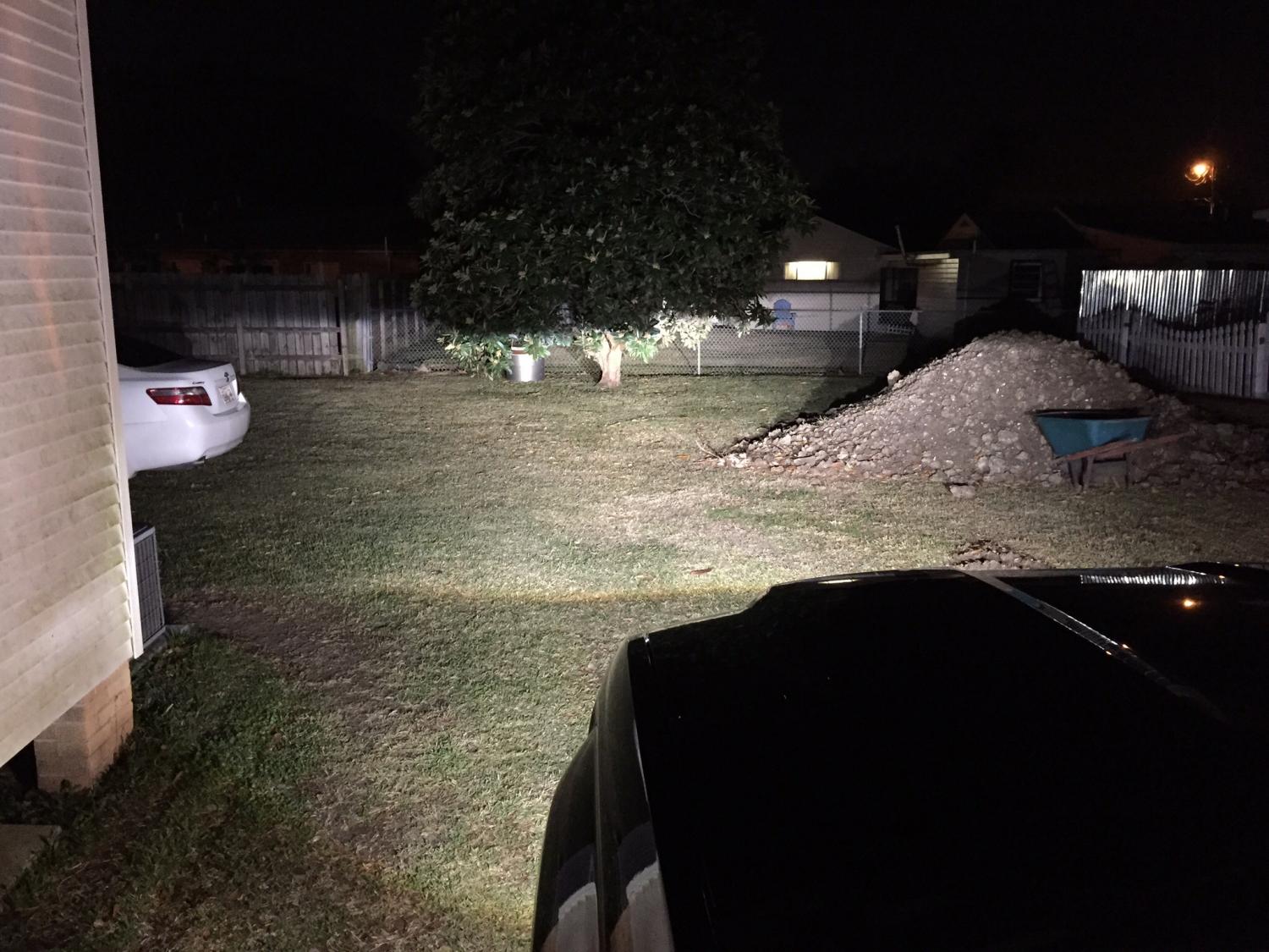

Would somebody be willing to take a before and after shot prior to going in for replacements, then after they get the new ones? I do not think my lights are terrible but more light can never hurt.
  • Replies 68
There is another thread with comparison shots from a member before and after the new bulbs and BCM flash. Its pretty significant a difference. Sorry I am on mobile, or otherwise I would link the thread.
edit
here you go, post number 555
http://www.gm-trucks.com/forums/topic/165447-headlight-illumination-issues/page-37
Wonder if the before pictures were 9012's(stock) or replacement 9011's which are 10 watts more?
A GM dealer wouldn't put in 9011 which was designed to NOT fit into 9012 housing.
Right, but when I had the 9012's in I could not see rural areas.9011's made a big difference,
