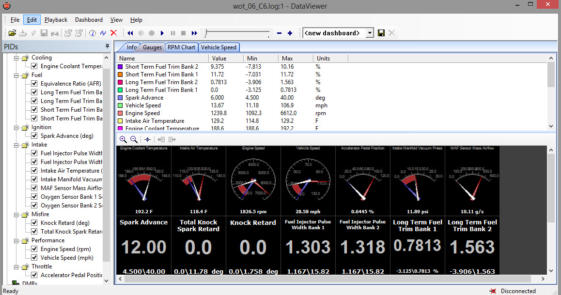

You can also log data while you drive. Then download and install the free DataViewer software they have, copy the logs to your computer, and view what you've logged. See my screnshot of it below.
