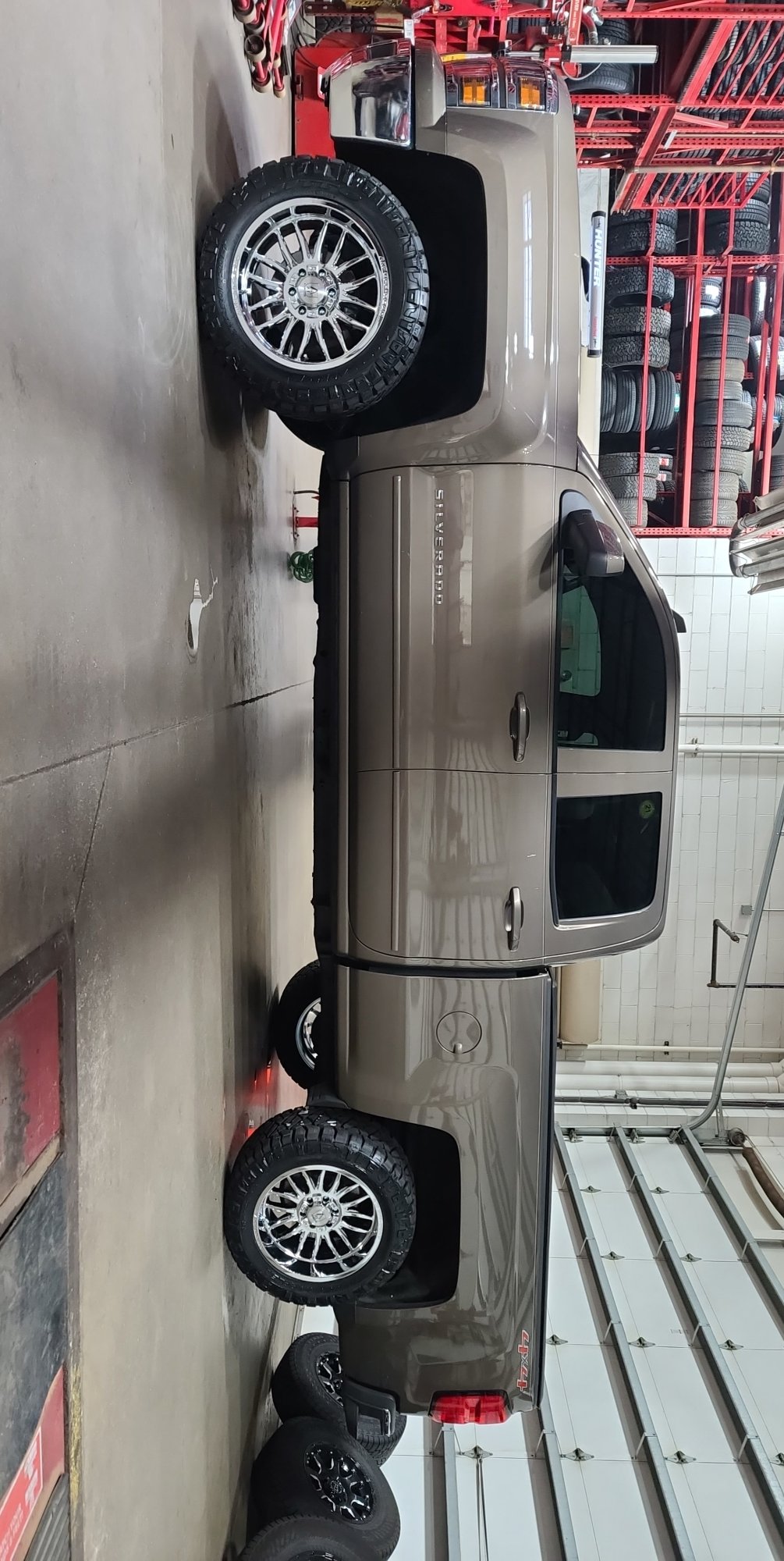

I have a 2.25" level from procomp. No issues so far. Been 2 years and about 45k miles. Running 20x10 33x12.50x20 for my summer set and 17x9 280/70/17 for my snow set.
