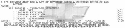

Anyone experience the front drivers side seat jiggle? The bottom part of the seat will shift a little bit back and forth while cornering. You can really replicate the problem on your own, you have to be under load and have the weight of yourself on the seat going around a corner to feel it. I mentioned it to my dealer while I was getting my AC plug fuse swapped and they said they had heard of it but hadn't worked on it yet. I figure it shouldn't be a big deal to have fixed under warranty but curious what others thought.

Just took my truck in yesterday for this fix. They said they knew all about it and had a shim kit fix for it. The ended up replacing the seat actuator yesterday and it fixed the problem. If it comes back I'll take it back and they can put the shim kit in it.

Had mine fixed last week for that. They knew about it and ordered what ever parts and called me when they came in and installed in about an hour. So far no movement. Happy happy
Did the fix from the other thread with the hose clamps, took all of two minutes and perfect since.
