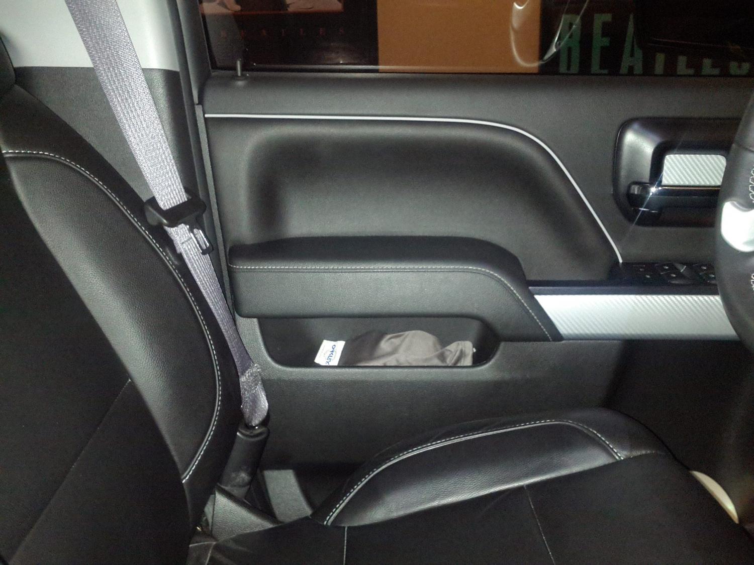

Just finished installing the Grey/Silver Piping to the 4 doors of my 2014 Sierra. If it helps, I found the material works best when cold. I put mine in the fridge for 5 minutes before installing. I used a 2 inch plastic putty knife to slide under the trim and worked the piping in next to it also a "v" cut into the piping makes the bend on the rear doors panels easier. The 4 doors took a total of 30 minutes.

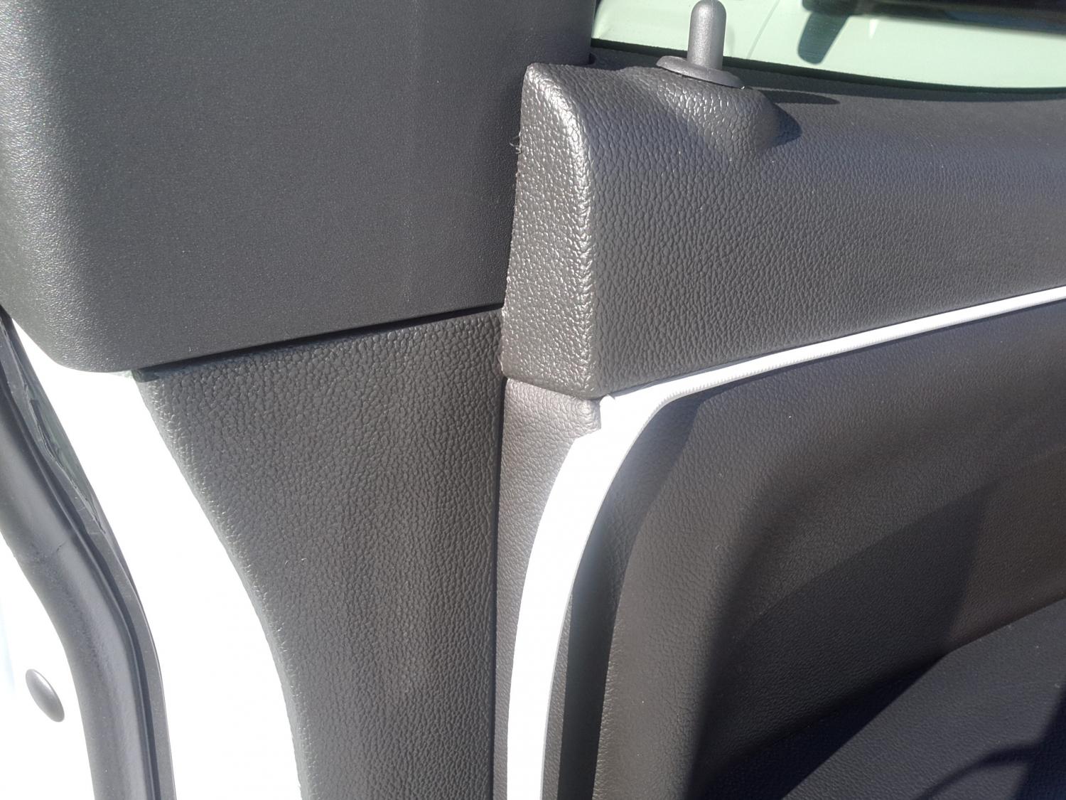

Do you have more oics? Looks white in the pic.

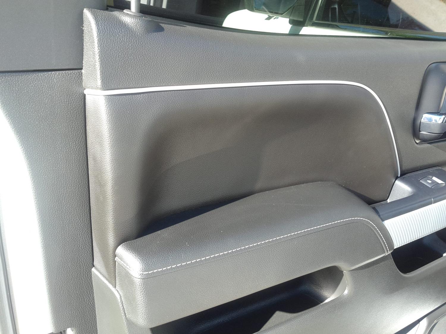

I have a picture of the rear door complete. It's been very sunny down here and piping does look white but rest assured it is a matted grey. Looks great with the brushed aluminum on the dash.
Silver ice, Hope this picture shows a little better of the grey. Thanks to Blue Topaz for the inspiration.
