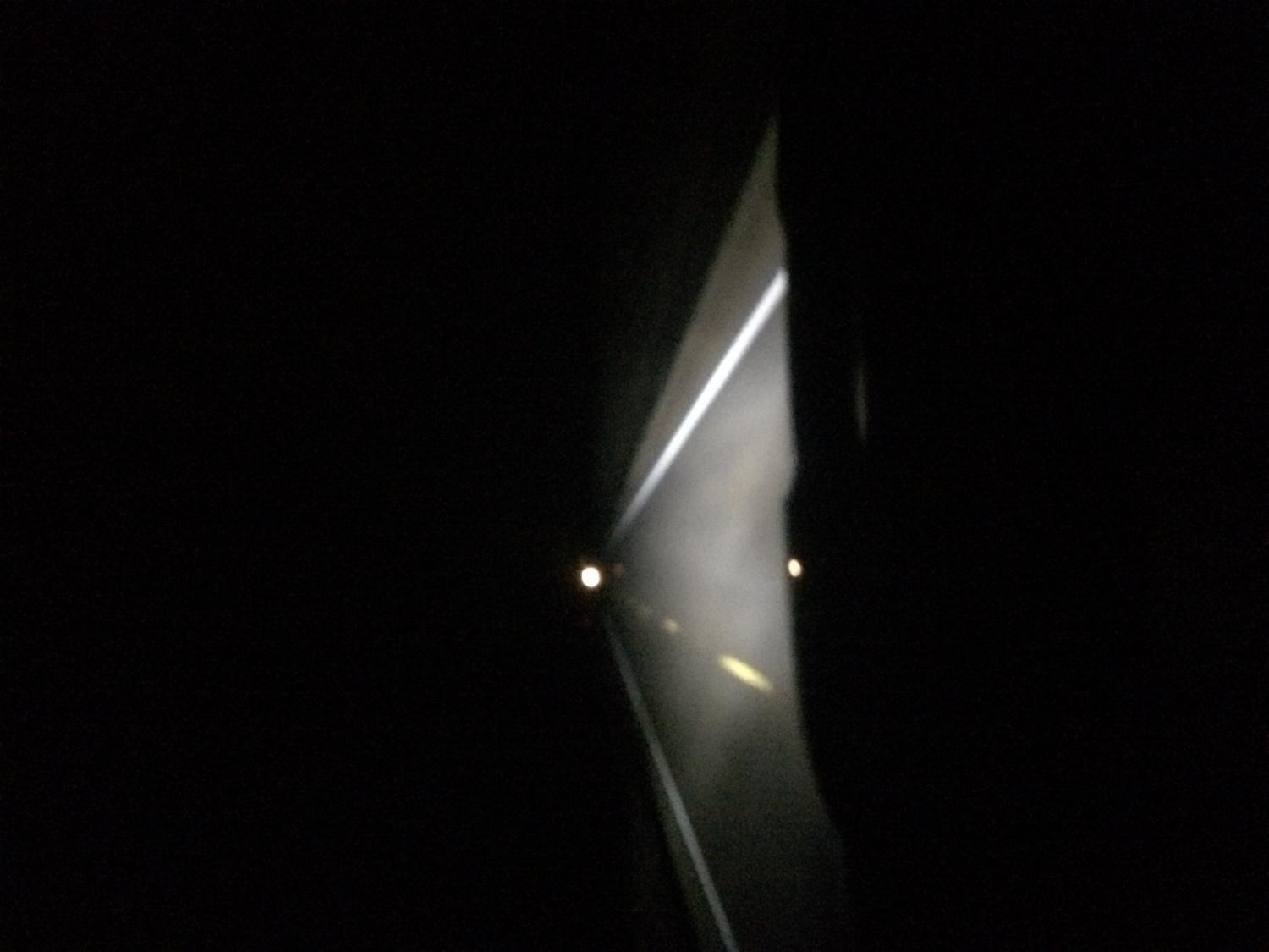

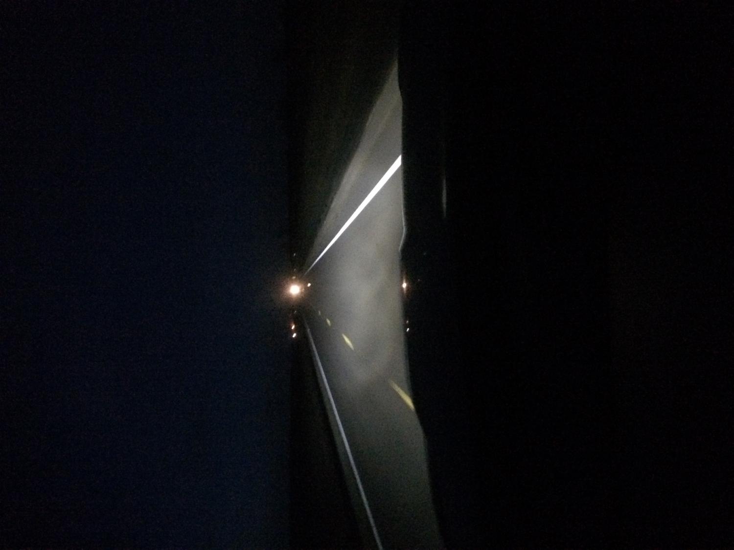

Has anyone that installed aftermarket led headlights had issues with the beam pattern being brighter towards the outside of the road. I put Vleds in and they seem to be brighter towards the opposite side of the road and the passenger side ditch. I have rotated them multiple times. I started with the 3 and 9 o'clock then went to 6 and 12 and now back to original orientation. They still are brighter towards the outside area instead of directly in front of the vehicle. I have adjusted the 2 10mm bolts for the headlight to aim towards the center and I did not get that much adjustment. Any tips for this issue? I did not have any issues with my hid kit being brighter towards the sides of the road. I like the idea of the led but need a better beam pattern

I just put these in my truck last week. They've been great, 100 times better than stock or the led opt7's i had in before. Very easy to install, no trimming and everything fits with the cover on. Just have to make sure the led's are at the 3 and 9 position. I highly recommend them.
by 3 n 9 can u explain more on that I replaced mine and noticed on the driver side I have a black spot towards the left of beam. I installed them exactly how u would stock bulbs and they locked in perfect
I've installed these without canbus and work perfectly. Only problem I'm having is with the left side having a black spot towards left of beam. I installed them just like a stock bulb and went as far right locking into place. By three and 9 position what are y'all meaning can anyone help..?
by 3 n 9 can u explain more on that I replaced mine and noticed on the driver side I have a black spot towards the left of beam. I installed them exactly how u would stock bulbs and they locked in perfect.
Think of a clock. The led diodes should face the 3 and 9. So if your looking at your truck from the front one led diode should face towards the grill and the other toward the fender.
so in other words the whole bulb itself will be facing vertical and diodes facing out to right and left bumper at 3-9
ame="Asells" post="1760928" timestamp="1455462269"] so in other words the whole bulb itself will be facing vertical and diodes facing out to right and left bumper at 3-9
Yes, if I remember right the wire should come out the bottom of light. Leds should face horizantal.
