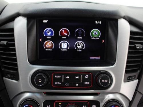

Found the truck I want, it just has OnstarNav. How difficult is it to add Nav to it? Or can it even be done?
anything can be done with enough money. but I sure it would be a headache. Probably best just to get a new aftermarket head unit with NAVI....... factory navi sucks. I use my google smartphone for Navi every time.
Even when my navigation was up to date, I didn't use it that much. Now that my navigation is 2 years out of date. I never use it. I turn on google maps and let it play over bluetooth. 10x better.
Don't waste your money OP.
Doesn't look difficult if this will work in your truck.
This is available for a 2015, not sure if it will work in a 2014
"Radio - Navigation
Add navigation functionality to your Silverado audio system with this Navigation Antenna Cable. MSRP - $975 "
Why you getting rid of yours already?
Guy at work offered me $4k more than its worth, he has been bugging the hell out of me lately so I sold it to him. Looking at a 2016.
The factory nav sucks!!!!! I have it in my ltz. Go by a garmin.
I'm not getting it to use it, Im getting it because Im OCD with vehicle options.
I have for sale a factory HMI Navigation unit with antenna that you swap with your HMI behind the glovebox
I bought it from Kodiakz a vendor here on the site for my 14 Sierra that didn't have navigation and he will reflash it to whomever buys it's VIN #
I am asking $600
That system is $1,900!!!! That's insane. Keeping Onstar is cheaper than getting the factory nav!
Hmmm I guess you called them because I don't see a price listed for the 14-15 trucks. If you are going off of the 07-14 pricing that is with upgrading from the base radio to the screen.
