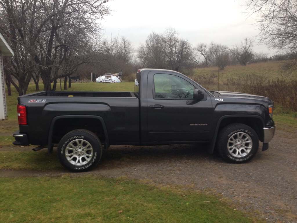

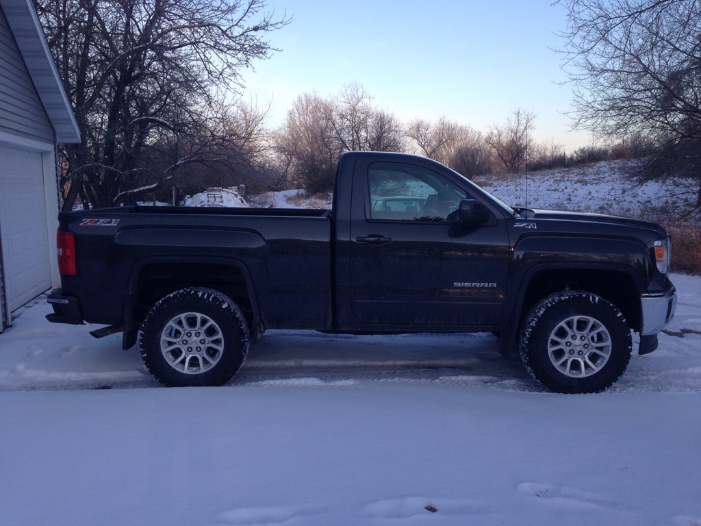

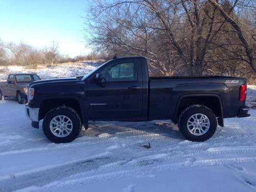

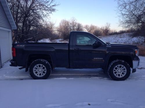

Finally got the icons installed very happy with them they gave me more lift than expected I added tires at the same time my total lift on the front was 3 5/8 inches which the tires alone raised the rear 1 inch so I figure the icons out of the box gave me about 2 5/8 inch lift on the front so I may bring them down a 1/2 inch the ride and handling is great compared to stock I did add e rated tires so I don't notice much on the highway still feel the road due to the tires but there are some very rough streets around here and that's were they really shine where I had to go really slow I can go as fast as I want amazing and the handling and cornering is great very happy with them here's a before and a couple after photospost-150713-145989185138_thumb.jpgpost-150713-145989187566_thumb.jpgpost-150713-145989190321_thumb.jpg

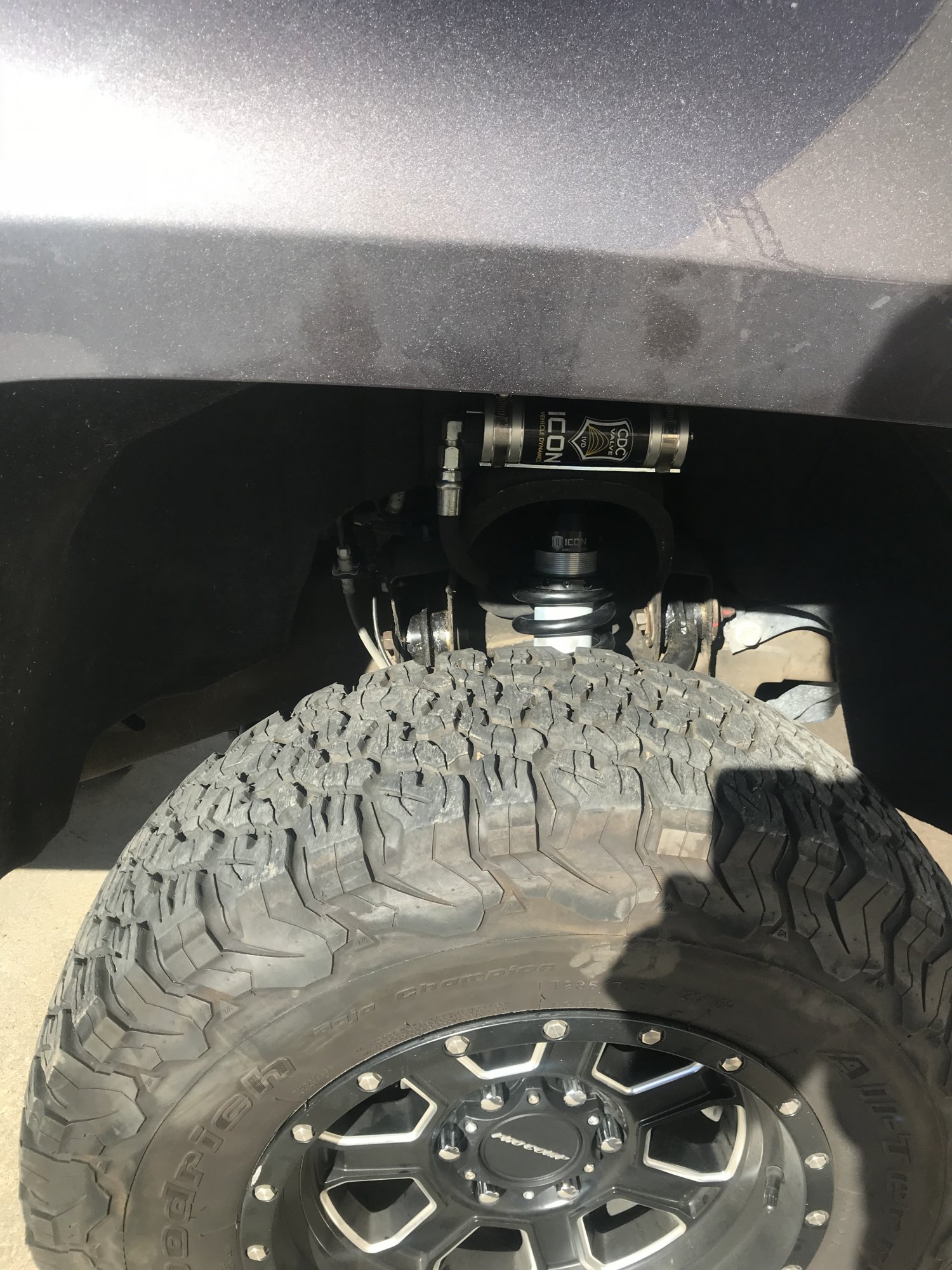

Does anyone have the stage 2 set up from icon? It's the set up with the control arms. If so, how do you like it? I have a 2014 sierra with aluminum ucas. I'm getting kind of tired with how rough the truck is on bumps....
Thanks in advance!Resized_LRM_EXPORT_20180421_003448.thumb.jpeg.99900a508d56ca4af59ad5cfeb793d69.jpeg
