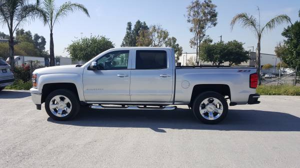

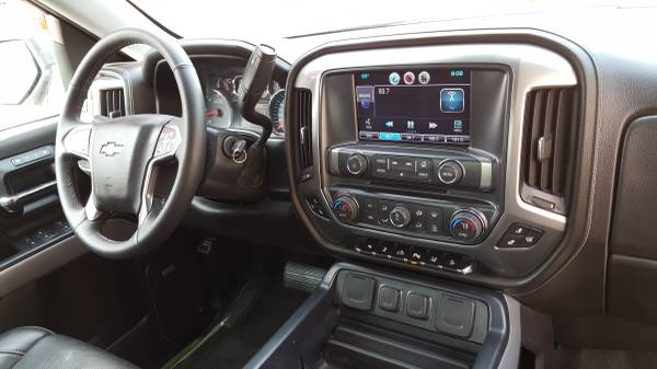

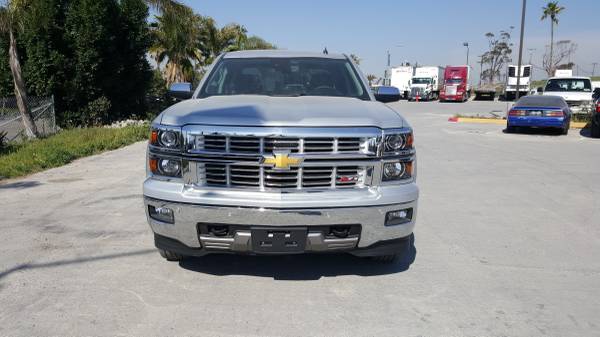

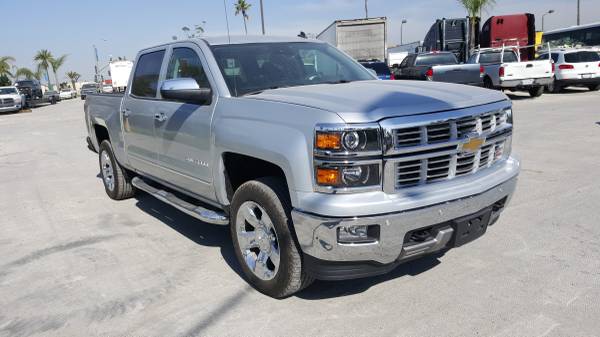

Yes, USAA covers salvage titles. So I'm covered there. I attached a few pics...Also, there is no more warranty. So maybe I will be the ginuea pig for DIY repairs.
