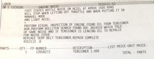

This time getting a superficial ticking noise taken care of. Also getting a trim level relearn as I never corrected for the 1" rear block. I found a bulletin on the c7 regarding the belt tensioner that sounds exactly like what I am hearing lets just hope sunrise gmc of Memphis can accept their solutions off of a silver platter lol it's amazing how much I have to beat into their heads that I know what the heck I am talking about!!!!
Thanks a lot they actually just called and want me to come get it. Although the tensioner on the truck is not hydraulic they did replace it and successfully performed a trim height calibration
I'm hearing this particular tick mainly under load at low rpm. Like any time I lug the motor. I'm almost to the point I think i could be hearing egr noises or maybe a lifter.
Nope still got the noise. I'll post heRe when I find it. I think it may be egr noise
