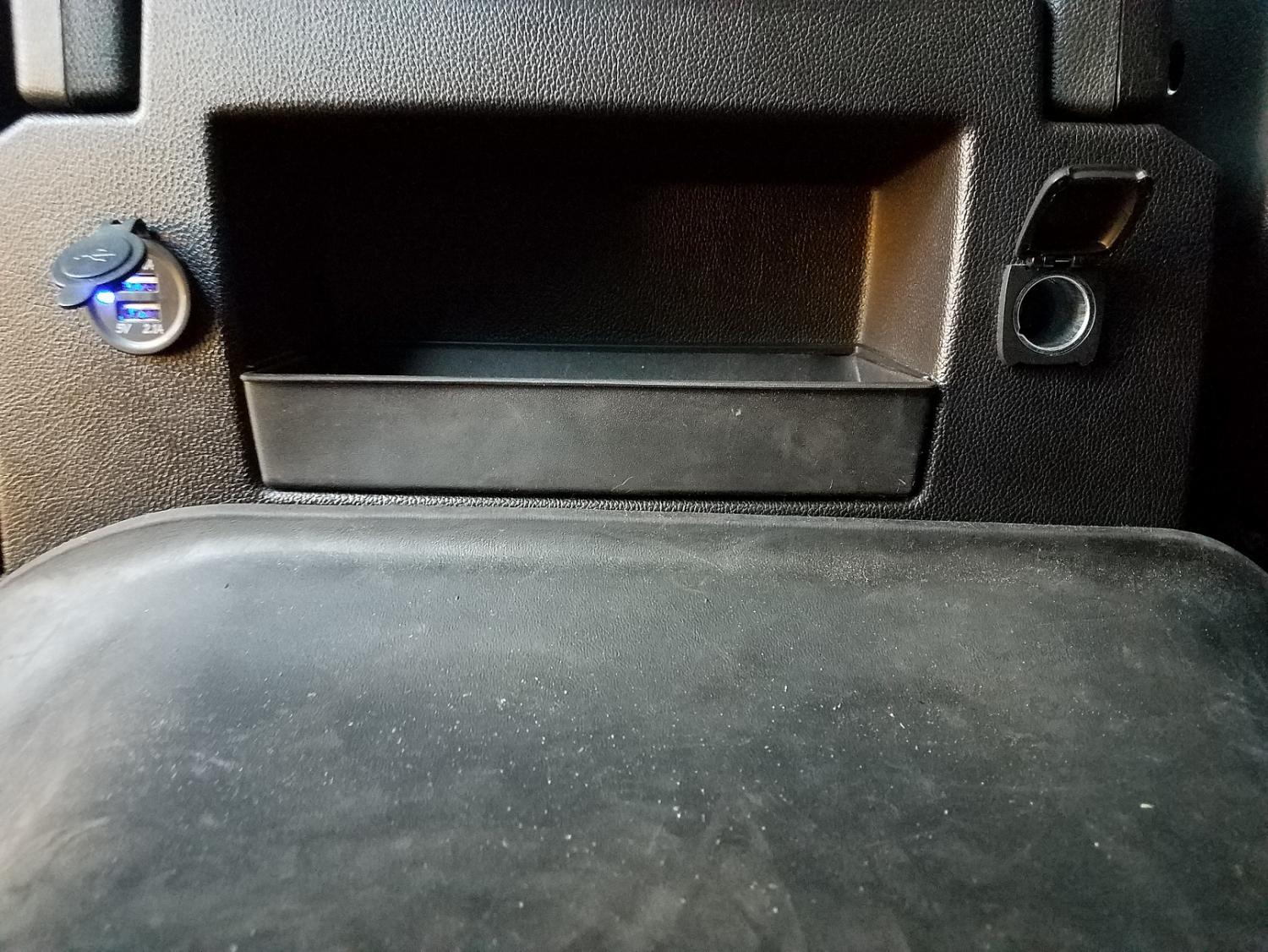

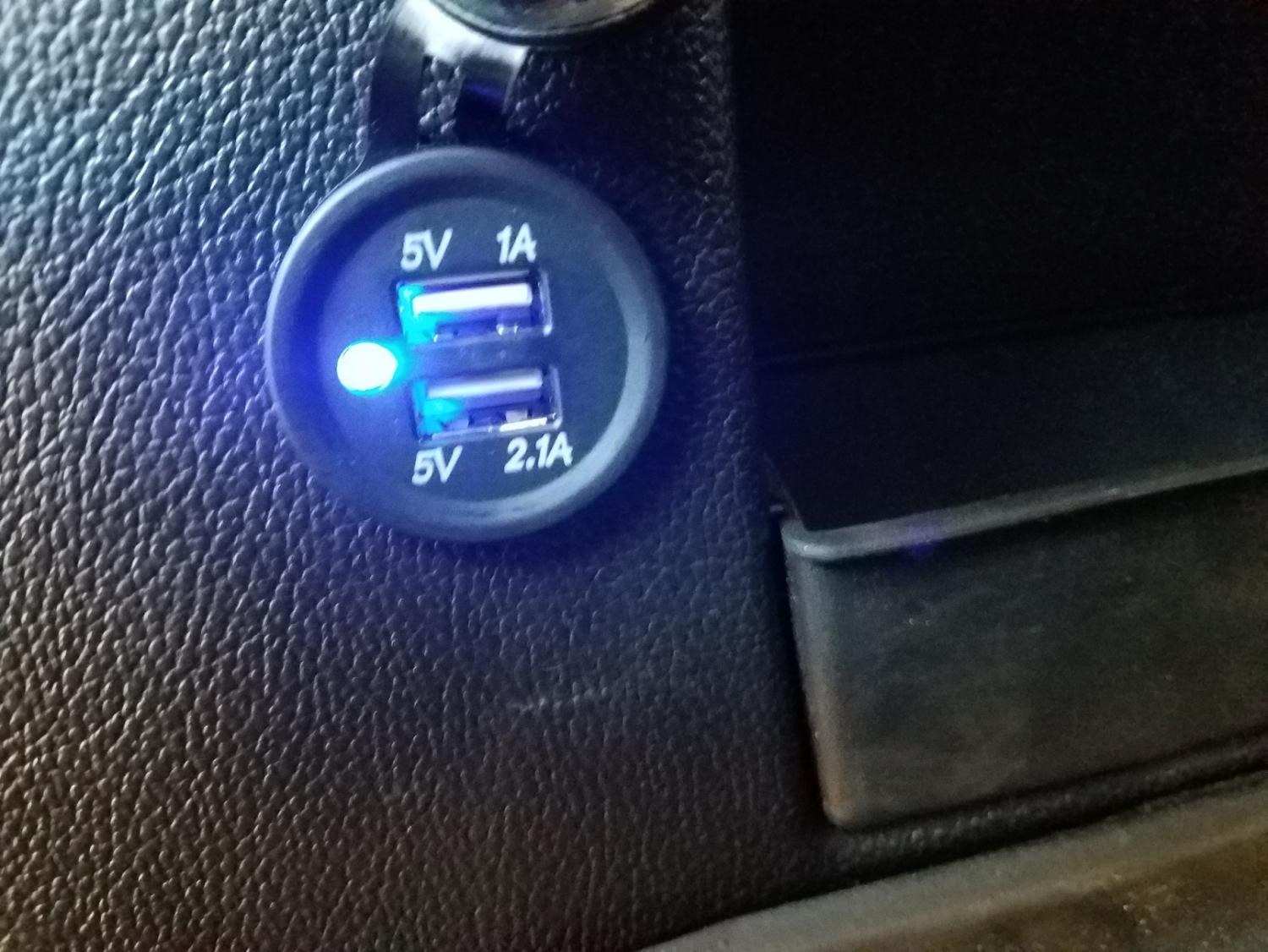

Added a dual USB adapter for the rear seat passengers. Very easy to do, total time took me about 20 minutes and that's because I finished my beer and had to get another one. :) The rear panel just pops off, grab it from the bottom and pull out. It then kind of lifts upward, unplug the 12 volt plug and that's it. Drill your hole, mount the adapter and tie into the plug wires on the right side of the panel. Or you can run them to the front if you want a constant 12v running to it. I wanted it to turn off with the truck so I just tapped into the wires there on the other plug. I didn't take pics while I had it off but it comes off so easy, I can take pics and post if anyone wants to see how I did it.
