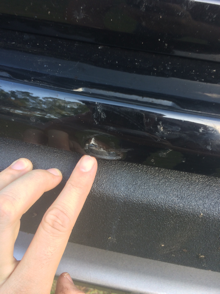

Here's the damage. My actual bumper is line x.
Which is awesome but this is also why I'm asking what should I do?
Would a heavy duty bumper look better ehhh?
Honestly I have to agree that it was just an accident. If that filler piece is all that got damaged then just replace it. By the way, probably should have used the rear hitch and not the front tow hooks to pull the stump.

i think most aftermarket bumpers still use the valence (that is what it is called, the one under is air dam) on the 1500's. the HD do not have one so if you were looking at a pic thinking it would not be needed. chances are it was a pic of an HD.
think your stuck buying a new one. they come unpainted.

The valance I could paint....or should I spray it with the line x also? It might look funny. Ideas on that guys?
