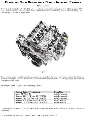

Did the engine crank noticeably slower or just crank longer? It's normal for these DI motors to crank longer to build fuel pressure.

As has already been said, the direct injection engines can crank for much longer than most of us are used to. Not a battery issue.
